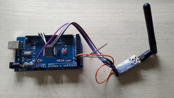

I am trying to use nrf24l01+pa+lna with Mega2560 and UNO to achieve wireless outgoing.
And I use a buck board to be the power supply to nrf24l01+pa+lna(Just TX).
Uno is transmitter
Mega2560 is receiver
And this is my code:

You've not indicated that you've tried any other sketches. Your best chances of getting your particular code to work, is to start with the tutorials that are provided here:
Introduction
The nRF24L01+ 2.4GHz transceiver modules are cheap and very effective but I have come across a few Threads in which people were having trouble with them so I thought it might be useful to gather together in one place a basic step-by-step sequence for getting them to work.
EDIT 03 Feb 2021 - For this Tutorial install Version 1.1.7 of the RF24 library (available with the Arduino Library Manager). More information in Reply #30.
Edit 29 Aug 2016. I have today downloaded and successfu…
Read the first post and the jump to post #30 to run the connection check sketch on your UNO.
You should also run the same sketch on your 2560, but using the appropriate SPI pins. Away from my bench so I don't have the pins to hand.
Post the serial output from the tests here so we can confirm that the modules are wired correctly.
I upload the connection check sketch:

And it print:
Mega2560:
// Mega2560
14:58:30.855 -> STATUS = 0x02 RX_DR=0 TX_DS=0 MAX_RT=0 RX_P_NO=1 TX_FULL=0
14:58:30.921 -> RX_ADDR_P0-1 = 0x0202020202 0x0202020202
14:58:30.954 -> RX_ADDR_P2-5 = 0x02 0x02 0x02 0x02
14:58:30.986 -> TX_ADDR = 0x0202020202
14:58:31.019 -> RX_PW_P0-6 = 0x02 0x02 0x02 0x02 0x02 0x02
14:58:31.052 -> EN_AA = 0x02
14:58:31.085 -> EN_RXADDR = 0x02
14:58:31.085 -> RF_CH = 0x02
14:58:31.117 -> RF_SETUP = 0x02
14:58:31.117 -> CONFIG = 0x02
14:58:31.150 -> DYNPD/FEATURE = 0x02 0x02
14:58:31.260 -> Data Rate = 1 MBPS
14:58:31.260 -> Model = nRF24L01+
14:58:31.316 -> CRC Length = 8 bits
14:58:31.320 -> PA Power = PA_LOW
14:58:31.320 -> ARC = 2
14:58:31.325 ->14:58:31.325 ->
14:58:31.325 -> AND NOW WITH ADDRESS AAAxR 0x41 41 41 78 52 ON P1
14:58:31.361 -> and 250KBPS data rate
14:58:31.366 ->
14:58:31.366 -> SPI Speedz = 10 Mhz
14:58:31.381 -> STATUS = 0x02 RX_DR=0 TX_DS=0 MAX_RT=0 RX_P_NO=1 TX_FULL=0
14:58:31.445 -> RX_ADDR_P0-1 = 0x0202020202 0x0202020202
14:58:31.478 -> RX_ADDR_P2-5 = 0x02 0x02 0x02 0x02
14:58:31.511 -> TX_ADDR = 0x0202020202
14:58:31.543 -> RX_PW_P0-6 = 0x02 0x02 0x02 0x02 0x02 0x02
14:58:31.577 -> EN_AA = 0x02
14:58:31.609 -> EN_RXADDR = 0x02
14:58:31.642 -> RF_CH = 0x02
14:58:31.642 -> RF_SETUP = 0x02
14:58:31.674 -> CONFIG = 0x02
14:58:31.674 -> DYNPD/FEATURE = 0x02 0x02
14:58:31.707 -> Data Rate = 1 MBPS
14:58:31.741 -> Model = nRF24L01+
14:58:31.741 -> CRC Length = 8 bits
14:58:31.773 -> PA Power = PA_LOW
14:58:31.773 -> ARC = 2
Uno :
15:36:36.262 -> CheckConnection Starting
15:36:37.861 ->
15:36:37.861 -> FIRST WITH THE DEFAULT ADDRESSES after power on
15:36:37.945 -> Note that RF24 does NOT reset when Arduino resets - only when power is removed
15:36:38.010 -> If the numbers are mostly 0x00 or 0xff it means that the Arduino is not
15:36:38.109 -> communicating with the nRF24
15:36:38.143 ->
15:36:38.143 -> SPI Speedz = 10 Mhz
15:36:38.176 -> STATUS = 0x00 RX_DR=0 TX_DS=0 MAX_RT=0 RX_P_NO=0 TX_FULL=0
15:36:38.242 -> RX_ADDR_P0-1 = 0x20206060e0 0x00000000c0
15:36:38.276 -> RX_ADDR_P2-5 = 0xe0 0xc0 0xc0 0x80
15:36:38.310 -> TX_ADDR = 0x0000000000
15:36:38.343 -> RX_PW_P0-6 = 0x10 0x00 0x00 0x70 0x00 0x70
15:36:38.399 -> EN_AA = 0xc0
15:36:38.415 -> EN_RXADDR = 0x80
15:36:38.415 -> RF_CH = 0x80
15:36:38.443 -> RF_SETUP = 0x00
15:36:38.443 -> CONFIG = 0x80
15:36:38.477 -> DYNPD/FEATURE = 0x00 0x00
15:36:38.477 -> Data Rate = 1 MBPS
15:36:38.510 -> Model = nRF24L01+
15:36:38.543 -> CRC Length = 8 bits
15:36:38.543 -> PA Power = PA_MIN
15:36:38.577 -> ARC = 0
15:36:38.577 ->
15:36:38.577 ->
15:36:38.577 -> AND NOW WITH ADDRESS AAAxR 0x41 41 41 78 52 ON P1
15:36:38.644 -> and 250KBPS data rate
15:36:38.677 ->
15:36:38.677 -> SPI Speedz = 10 Mhz
15:36:38.710 -> STATUS = 0x00 RX_DR=0 TX_DS=0 MAX_RT=0 RX_P_NO=0 TX_FULL=0
15:36:38.744 -> RX_ADDR_P0-1 = 0x20202020e0 0x00000000c0
15:36:38.811 -> RX_ADDR_P2-5 = 0xe0 0xc0 0xc0 0x80
15:36:38.844 -> TX_ADDR = 0x0000000070
15:36:38.878 -> RX_PW_P0-6 = 0x10 0x00 0x00 0x70 0x00 0x70
15:36:38.911 -> EN_AA = 0xc0
15:36:38.944 -> EN_RXADDR = 0xc0
15:36:38.944 -> RF_CH = 0x80
15:36:38.978 -> RF_SETUP = 0x00
15:36:38.978 -> CONFIG = 0xe0
15:36:39.011 -> DYNPD/FEATURE = 0x00 0x00
15:36:39.011 -> Data Rate = 1 MBPS
15:36:39.044 -> Model = nRF24L01+
15:36:39.087 -> CRC Length = 8 bits
15:36:39.087 -> PA Power = PA_MIN
15:36:39.087 -> ARC = 0
15:36:39.087 ->
Here are the question, why data rate changed to 1 MBPS, I set it at 250KBPS?
