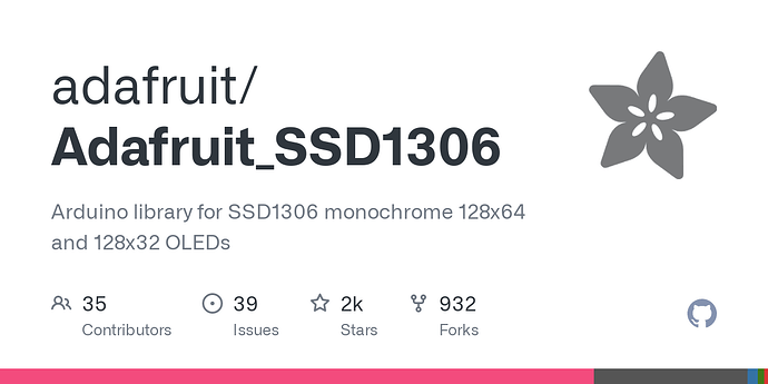

hello i found a few sketches for oled lcd displays some spi some i2c but not for a blue/yellow display 0.96 128x64 i bought it from ebay http://www.ebay.com/itm/191285233516?_trksid=p2060778.m2749.l2649&ssPageName=STRK%3AMEBIDX%3AIT but i can not find a sketch or library to work i tried the adafruid one from github and nothing i get error from it..
C:\Users\BigGreen\Desktop\arduino-1.0.5-r2\libraries\Robot_Control\ArduinoRobot.cpp: In constructor 'RobotControl::RobotControl()':
C:\Users\BigGreen\Desktop\arduino-1.0.5-r2\libraries\Robot_Control\ArduinoRobot.cpp:8: error: 'LCD_CS' was not declared in this scope
C:\Users\BigGreen\Desktop\arduino-1.0.5-r2\libraries\Robot_Control\ArduinoRobot.cpp:8: error: 'DC_LCD' was not declared in this scope
C:\Users\BigGreen\Desktop\arduino-1.0.5-r2\libraries\Robot_Control\ArduinoRobot.cpp:8: error: 'RST_LCD' was not declared in this scope
C:\Users\BigGreen\Desktop\arduino-1.0.5-r2\libraries\Robot_Control\ArduinoRobot.cpp: In member function 'void RobotControl::begin()':
C:\Users\BigGreen\Desktop\arduino-1.0.5-r2\libraries\Robot_Control\ArduinoRobot.cpp:18: error: 'MUXA' was not declared in this scope
C:\Users\BigGreen\Desktop\arduino-1.0.5-r2\libraries\Robot_Control\ArduinoRobot.cpp:18: error: 'MUXB' was not declared in this scope
C:\Users\BigGreen\Desktop\arduino-1.0.5-r2\libraries\Robot_Control\ArduinoRobot.cpp:18: error: 'MUXC' was not declared in this scope
C:\Users\BigGreen\Desktop\arduino-1.0.5-r2\libraries\Robot_Control\ArduinoRobot.cpp:18: error: 'MUXD' was not declared in this scope
C:\Users\BigGreen\Desktop\arduino-1.0.5-r2\libraries\Robot_Control\ArduinoRobot.cpp:19: error: 'MUX_IN' was not declared in this scope
C:\Users\BigGreen\Desktop\arduino-1.0.5-r2\libraries\Robot_Control\ArduinoRobot.cpp:22: error: 'BUZZ' was not declared in this scope
C:\Users\BigGreen\Desktop\arduino-1.0.5-r2\libraries\Robot_Control\ArduinoRobot.cpp:25: error: 'Serial1' was not declared in this scope
this is the sketch i used that i found
i can't post the sketch in here can't i exceeds the max length of 9500 characters
this is where i got the library
and
not sure what to do can someone please help me?
