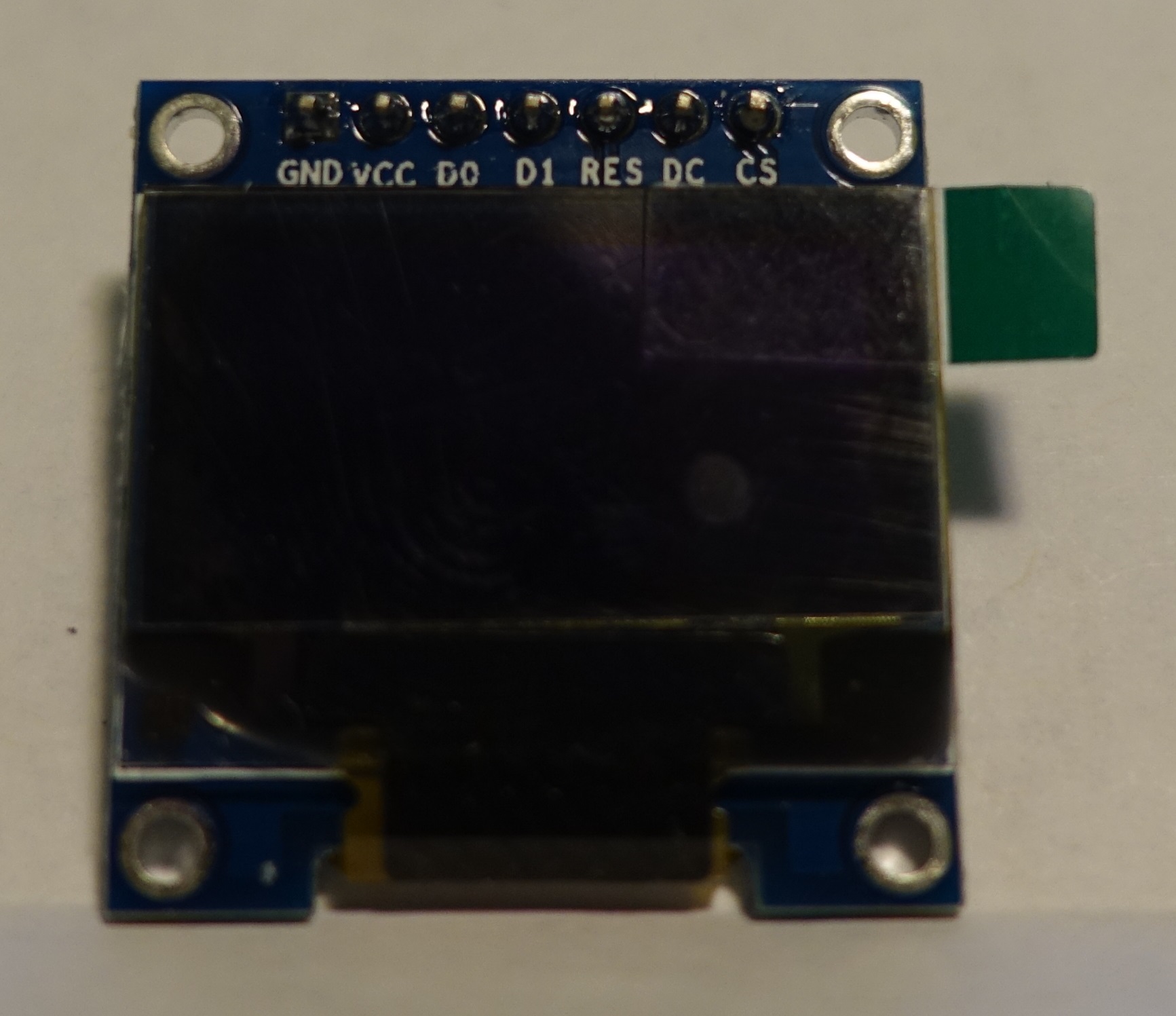

I'm having no luck with a similar display. It has 7 pins:
GND VCC D0 D1 RES DC CS
I can connect with the Adafruit example with 4 wire SPI however I can not get it to work with I2C.
The back of the board is clearly marked with the 3 options
  1. I2C
  2. 3 wire SPI
  3. 4 Wire SPI
...and I can see that it is set-up for 4 wire SPI as default. I've moved the SMD resistors to match
the requirements but can get no display at all.
The G8lcd library seems to be clear on which pins to use for SPI but I can not find a reference to the pins required for I2C.

A0 (I take it this is Analogue Pin 0 on the Arduino), but where is the SCK pin on the Arduino???
Attached are 2 photos of the OLED in question! Any help much appreciated

A0 and SCK are the names for the pins in the U8glib constructor. A0 means address line 0 and is identical to the pin named D/C.
A0 has nothing to do with Analog pin 0 (excause for the confusion): You can use any digital pin. if you have a working setup with the Adafriut lib in this way:
#define OLED_MOSI   9
#define OLED_CLK   10
#define OLED_DC    11
#define OLED_CS    12
#define OLED_RESET 13
Then the u8glib constructor will be:
U8GLIB_SSD1306_128X64 u8g(10, 9, 12, 11, 13); // SW SPI Com: SCK = 10, MOSI = 9, CS = 12, A0 = 11, RST = 13
Oliver
Ok, the issue was the RESET pin which needs to be added as the 5th argument in constructor. In my case pin 13. Here's what worked on Arduino Pro Mini. (Note that I don't have the CS pin on my display, so the pin 12 in the constructor below is not actually used)
