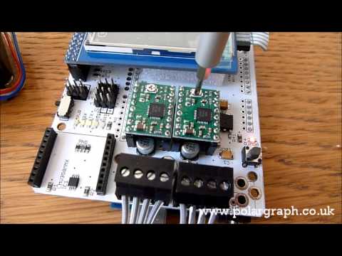

I was unable to get 0.4 to show on any driver. Turning the screws didn't change readings on the multimeter.
We finally got it. The problem we found is because our plug converter also include transformer function which we did not switch it off. After we did that everything works as expected and we tune the potentiometer until the motor preform better by listen the sound of the motor. We test print some 3D models and tune our temperature for less strings during the printing process.
badmole:
The voltage readings are the screws themselves. As they said, the voltage does not need to be exactly but only to adjust for better performance on the motors by listen to the sound. See the following video for better understanding.
