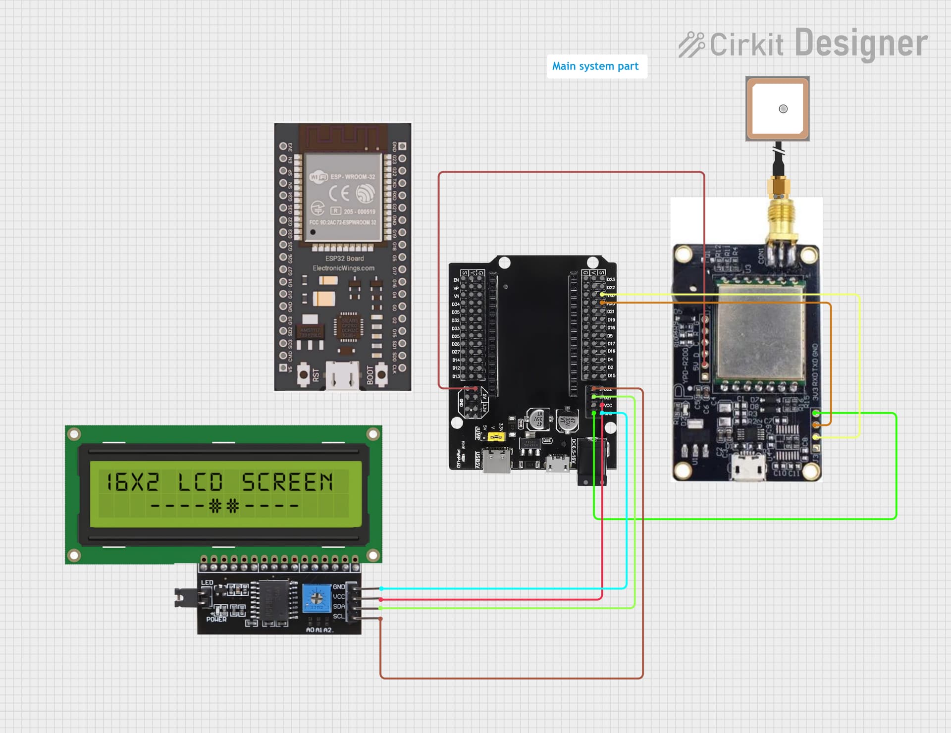

how do you power the system?
can you upload a schematic showing the wiring and power supplies?
I have edited the post and code sir. Reader gets 5v from esp32 (expansion board). RXD from reader to esp32 TX2 (gpio17) and TXD to esp32 RX2(gpio16).
Here's the schematic sir.
