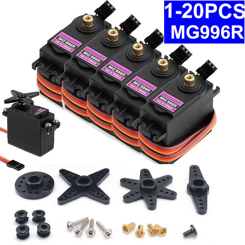

I am looking at these servos for a swap out:
MG996R digital servos:
Not sure how much 'torque' a gram amounts to? but seems to be a little over double (running it @ +5v) than the current servos in the set-up

Obviously you missed the point of the change to the MG servo.
Idea was to trash the radio shack gear and use a common brand which already has 4 sets of arms provided.
So 3 spare sets per servo once you use one on your project.
Servo arms , no matter which brand, will not be any longer than provided as shown.
As far as I am aware, spline count is the same as Futaba (25).
For torque requirement you will need to know what amount of weight is placed on the round bar @ the 2" mark. I suspect the poster of the video had problems also as the obvious use of 2 servos.
Not really a good setup to have output arms fixed together given no 2 servos are exactly the same in travel or speed.
A gram is not torque, it is weight and Google is a good reference in case you haven't heard of it.
