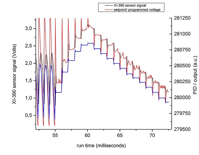

what I should do to make the setpoint not hold at every value for a second, but say, start from 0 Volts, ramp to 3.0 Volts with maximum speed, wait there for 10 milliseconds, and then ramp down again to zero. As of in the picture posted.

Nothing on that graph looks anything like a 'ramp'. It sounds like you are confused about what it is you are trying to accomplish. Perhaps you should start with what the goal is and not jump into designing code until the specifications are clear.
i doubt that the strong oscillations measured on my setup could be as a result of the stepwise behavior of the setpoint variable, or at least what is happening inside the fucntion ramp_hold_dump(). or maybe event loop() aka void loop().
I'm very much confused by the labeling of your graphs.
Graph "No1":
The X axis runs from under 55 to over 70 and is labeled "run time (milliseconds)". It looks like you may have meant "(seconds)".
The "setpoint/programmed voltage" line has some major spikes and appears to step about once per "millisecond" (second?).
The blue line is not labeled at all. There is an axis labeled "PID/output (a.u.)" What is an "a.u." in this context?!?
Graph"No3":
the X axis runs from about 5000 to about 7750, is labeled "run time (milliseconds)"?!?
The "XI-390 sensor signal (Volts)" rises from 0.0V at 5000 mS to level out around 1.75V at about 6500 mS.
The "setpoint/programmed voltage" is slamming between 0V and 3.3V about 24 times per second.
The "PID/output" seems to be tracking the sensor signal but ranges from 395000 to 422000.
The graphs are not going to help without at least a better description of where the data comes from.
It appears that you are using a PID loop to get a specific ramp out of your sensor. I suspect you are changing the setpoint too infrequently so the jumps in Setpoint cause a spike in Output. If it were me, I'd change the Setpoint as frequently as possible.
Hi John, thanks for your feedback.
In Graph "No1" the X-Axis scale is wrong, Please see the updated Graph "No1". The Setpoint/programmed Voltage and what it does comes from the function we discussed earlier here "Ramp_Hold_Dump()" function. Also the "PID/Output" blue curve is the PID output, calculated and plotted but in arbitrary units, because I don't know what kind of measurement unit it has. So I wrote on graph a.u.= arbitrary units.

With Respect to "Graph No3"
The X axis runs from 5000 till 7000 and is in milliseconds, it is results of the millis() function printed in serial and always starts from 5000, no idea why.
The data comes from the Due, which reads out the analog signal from a sensor, then compares with the setpoint, which in our case is the setpoint_value_Ramp_Hold_Dump() function, and then calculates the amount of voltage it needs to output on both DAC's, which are connected to sensor as super tiny heaters.
Have you decided what you want the signal voltage curve to be?
yes, the signal voltage curve should be/look as a rectangle/square function, starting from 0.0 Volts, then 3.279 Volts, staying at 3,279 for 10 µicroseconds, then going down to 0.0 Volts. Also it is important to do it as fast as possible. One more question: is there a chance to achieve a simple PID cycle rates of 1-20 microseconds? on Arduino Due.
