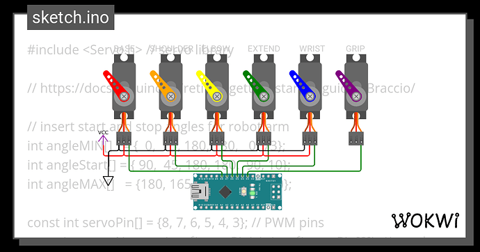

I was looking around for a sketch or instructions on how to make a robot arm move randomly. I want it to move in whatever direction it can on its own just for entertainment, like a random blinking light. Is there link to one or instructions on how to write the sketch?
Thanks
When you have your robot arm set up and you are able to make it move, you can use random function for the movement.
random(min, max)
Your robot arm has two limits on each servo you must program. See this simulation, adjust the pin numbers to your robot arm, and the min and max values, replacing "0" and "180" with angleStart[servoPin[]] and angleStop[servoPin]].
