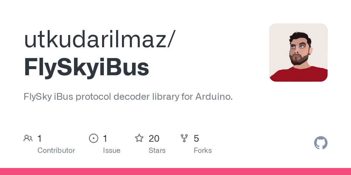

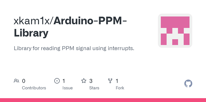

There are affordable to cheap data radio systems, good
You might benefit from using library.
Here's one
or if your receiver outputs PPM
there are other libraries that do the same thing, those are just the first I found googling.
Decoding N channels of PWM is not the way to go.
