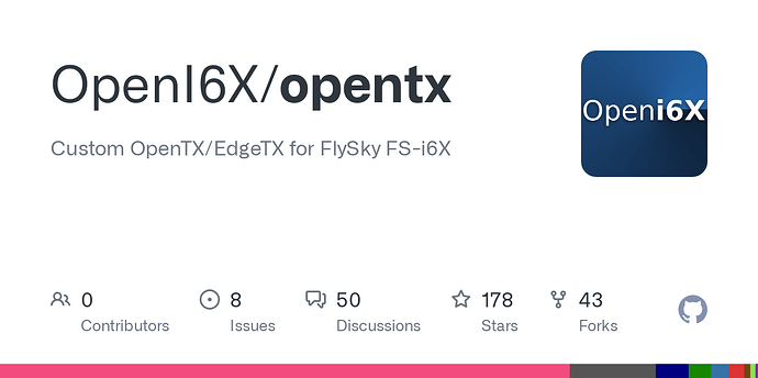

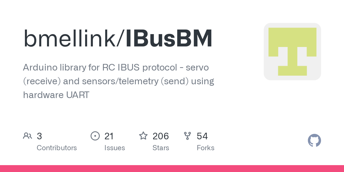

@heckerp1 ,
I'd recommend you consider using the iBUS protocol used by Flysky/Turnigy receivers, and maybe the OpenI6X firmware for the handset if you're interested in telemetry. Take a looks at these links.
