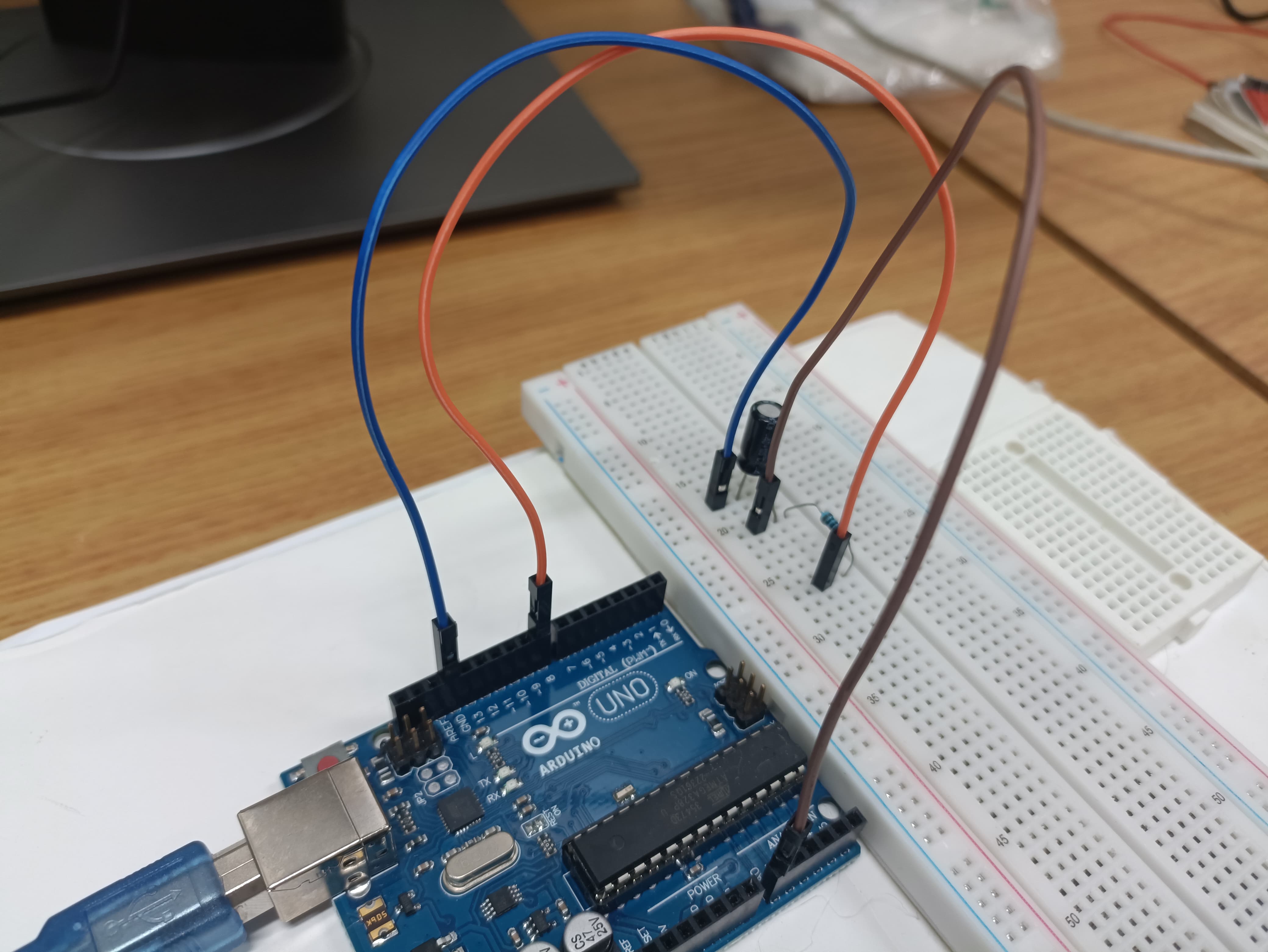

RC Circuit with serial plotter
I want to use the Serial Plotter to demonstrate the charging and discharging of a capacitor for educational purposes, helping students visualize the input voltage and the voltage across the capacitor. My goal is to clearly show the exponential increase and decrease during charging and discharging. Additionally, I want to label the x-axis as time (in milliseconds) and the y-axis as output voltage (in volts), allowing students to observe the real-time data and pick out the time constant directly from the plotter graph. However, I'm having trouble achieving this and could use some assistance.

Have you calculated the time constant of your capacitor charging circuit and compared it to the 20 second period of the forcing?
Eyeballing it from the early graphs you showed, it seemed less than 0.07sec.
the time constant is 100 microFarad * 10 kilo ohm = 1 second
Then the plots you show look like there might be a wiring error.
Please post a schematic and good pictures of your wiring

The circuit looks reasonable. 100uF and 10Kohm? Is the electrolytic capacitor connected with the correct polarity?
Your graphs look like they reach full voltage in 1 or 2 100ms points:
... which doesn't at all match a:
Do you have a DMM/meter so you can check the actual values?
Or watch the voltage rise on the meter? You could put a meter across the cap, take the arduino out of the circuit and pulse the resisor manually with a jumper to +5/gnd and see what the meter measures. If the circuit is healthy, you should be able to calcualate the time of a pulse from the voltage of the DMM.

I wonder whether your problem is the capacitor not making proper contact with the breadboard.
You were right, DaveX! I used an ohmmeter to check the continuity of each wire, and I found one that wasn’t conducting properly. I replaced it, and now I’m getting the results I was looking for. Haha! See it.
