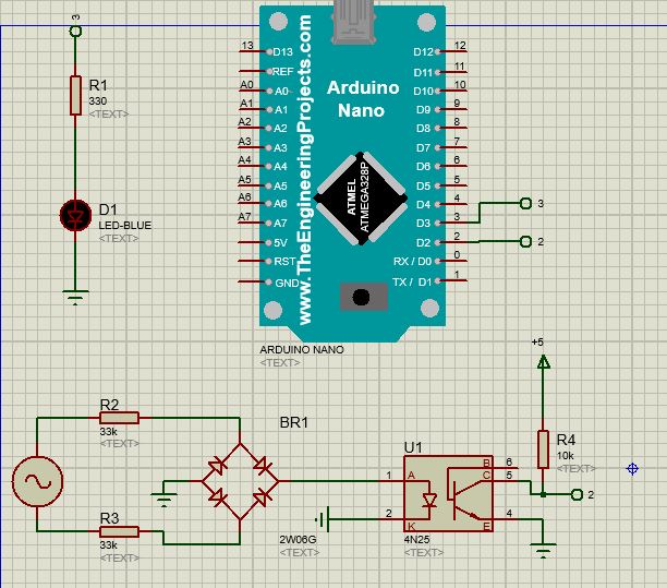

Hello guys,
I know this post is a little old.....but I'm trying to build this circuit following the tutorial provided by Instructables:
I modified it for 120V 60Hz. It seems that the zero-crossing is actually working, but the LED doesn't turn on, not even blink
The circuit is not complete, as I am missing the triac....but I wanted to test this part first. If the LED works, then the rest is pretty obvious.
Thanks in advance for your help.
Best,
JCS
Attached is the schematic on Proteus.
Here's the code.

In the program pin 2 is chosen
int AC_LOAD = 3; // Output to Opto Triac pin
int dimming = 128; // Dimming level (0-128) 0 = ON, 128 = OFF
pinMode(AC_LOAD, OUTPUT);// Set AC Load pin as output
attachInterrupt(0, zero_crosss_int, RISING); // Choose the zero cross interrupt # from the table above
//the interrupt function must take no parameters and return nothing
void zero_crosss_int() //function to be fired at the zero crossing to dim the light
// Firing angle calculation : 1 full 50Hz wave =1/50=20ms
// Every zerocrossing thus: (50Hz)-> 10ms (1/2 Cycle)
// For 60Hz => 8.33ms (10.000/120)
// 10ms=10000us
// (10000us - 10us) / 128 = 75 (Approx) For 60Hz =>65
int dimtime = (65*dimming); // For 60Hz =>65
delayMicroseconds(dimtime); // Wait till firing the TRIAC
digitalWrite(AC_LOAD, HIGH); // Fire the TRIAC
delayMicroseconds(8.33); // triac On propogation delay
// (for 60Hz use 8.33) Some Triacs need a longer period
digitalWrite(AC_LOAD, LOW); // No longer trigger the TRIAC (the next zero crossing will swith it off) TRIAC
for (int i=5; i <= 128; i++){
dimming=i;
delay(8.33);
