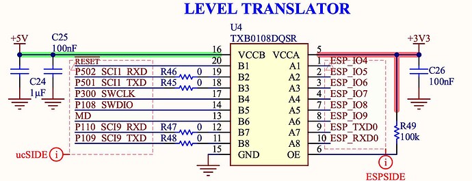

My understanding is that both Serial1 in Minima and Serial in WiFi use UART class. And also Serial in WiFi is connected ESP32-S3 which bridges between usb and serial. It means Serial in WiFi go through the level translation IC:
So the first question is: My understanding is right?
On the other hand, in the following schematics, WiFi would be able to connect directly to USB by setting P408 to HIGH.
Second the question is: Did you find any code that sets P408 ?
I think the relation between RA4M1 and ESP32-S3 causes some issues that are found at Firmware update fails if Serial Monitor/Plotter is open #2060 and Display output from Arduino Firmware Uploader #2220.

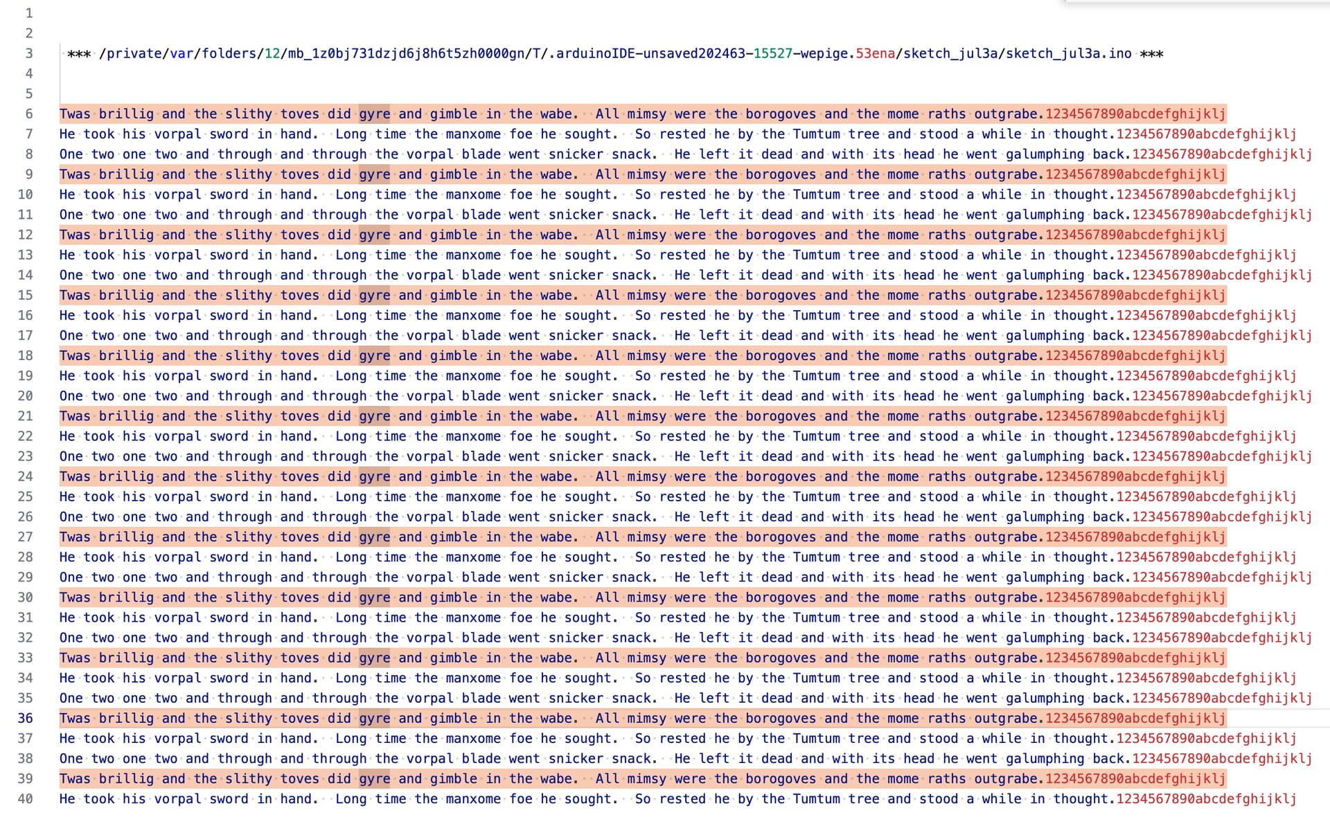

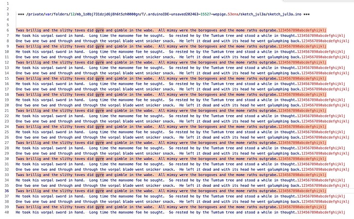

Hi @Delta_G ,
I tested your code at post #8 (except adding delay(1000) before Serial.println("\n\n *** " __FILE__ " ***\n\n");) and I've got different results from yours. i.e. No letters are missing.
Here's Serial:
And Serial1:
What is the difference between mine and yours? The UNO R4 WiFi board? The firmware on ESP32-S3 (0.4.1)? The PC (mine is a Mac)? The IDE (ver. 2.3.2) ? Or the USB cables?

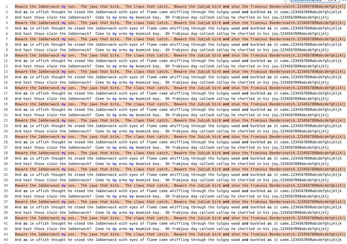

In fact, I have experienced the phenomenon where the last character of consecutive Serial output characters is missing with my UNO R4 WiFi. However, I am not able to reproduce it at the moment.
WiFi.
I copied & pasted your code at post #16 . No letters are missing.
Here's result of Serial1:
I haven't done any modifications or compiling, just using the official IDE out of the box.
