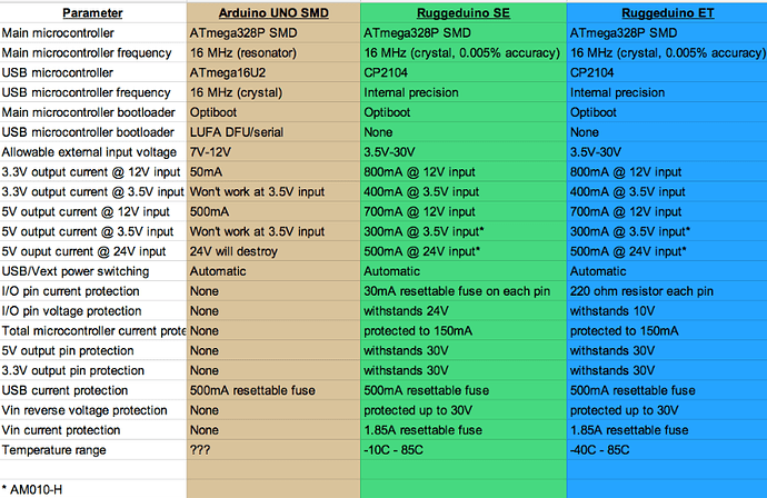

I've never bought one (duty fees make these too pricey for the things I make) but always wondered how well they live up to the claims. Anyone buy from
https://www.rugged-circuits.com/microcontroller-boards/
