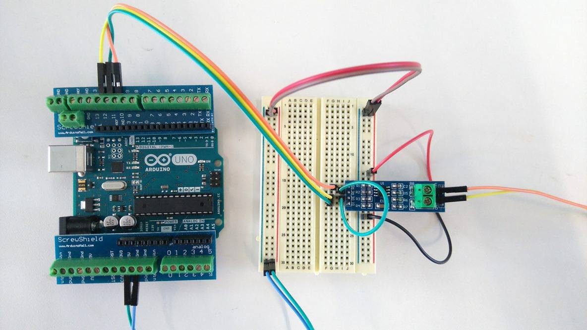

Hello,
Here is the code that I'm using and I attached an image too for illustrating the connections
Could someone help me ?

Your Original Post said you were using a Mega which would be much better because it has extra HardwareSerial ports. But your photo shows an Uno.
If that was my project I would start by "listening" with the second example in Serial Input Basics
What is the purpose of the SSerialTxControl ? Post a link to the datasheet for the device you are using.

What is the device on the right of the breadboard in the picture in Reply #4. I'm guessing that converts RS485 to TTL. Please post a link to its datasheet.
I suspect that the link I already gave you will be sufficient - but I need to read the datasheet. RS485 is just an electrical specification to provide reliable transmission.
