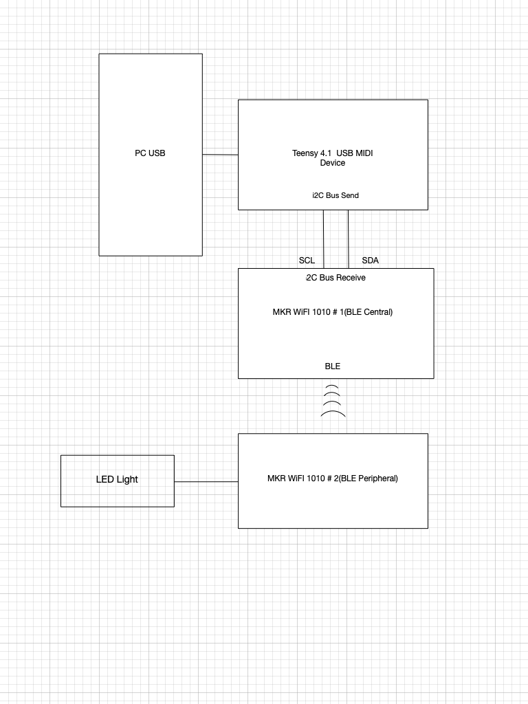

Hello,
I have a project where I am sending an LED on/off command from a Teensy 4.1 to an MKR Wifi 1010 via I2C using Wire.h and then need to send that same LED on/off via BLE to a second MKR Wifi 1010 that will have an actual light attached to it. I have setup the first MKR as the Central and the second MKR as the Peripheral with an LED Service and a Characteristic that I can write to and all of that is good. I can read the on/off via the I2C bus and light up the local LED on the Teensy as well as the Builtin LED on the first MKR fine. As a BLE test, I can also send an LED on/off loop to the second MKR via the Characteristic.writeValue and that also works fine. The part I'm stuck on is how to take the Wire.read LED on/off and send that via LED Characteristic.writeValue?
Here is my code and the heart of the read/write are towards the bottom. Thanks for any help on this.

Can You draw a logic block diagram showing the builld?
You talk about "Characteristic.writeValue"..... It's not clear how/where/why it's used.
Yep... heading home and I'll do it ASAP. Thanks
Hello @Railroader! What I mean by "Characteristic.writeValue".. At the end of my code there is this code that shows how I can write the LED Characteristic to MKR #2 via BLE. Whats in the code right now is just a simple LED Blink being written via BLE to the second MKR-and this works fine. Right below that is the "void receiveEvent" code that is being received by the Wire iC2 READ and it assigns a variable X(or 1 or a 0) and turns on/off the local LED on MKR 1- This works fine. So now that I have proved I'm receiving the blink message from the PC>to the Teensy>to the MKR #1 via iC2 - and I have a good BLE link from MKR 1 to MKR 2 now I'm trying to understand how I get my Wire read via the iC2 bus to blink on my MKR 2 via BLE. Everything I have tried gives me the "not declared in this scope" error. Like trying to write to the ledCharacteristic.writeValue right from the x= Wire.read code.

That is a compiler error and no code is downloaded.
Please post the entire error code.
Here's the whole sketch with trying to print to the ledCharacteristic.writeValue at the bottom.

Returns this error:

Compilation error: 'ledCharacteristic' was not declared in this scope
This variable is change within an interrupt routine, and should be declared volatile. It should also be a byte, as you are reading a single byte in the receive event.
//int x = 0;
volatile byte x = 0;
Then, I would use this variable as follows.
void receiveEvent(int howMany) {
    x = Wire.read();    // read one character from the I2C
Then in while (peripheral.connected())
while (peripheral.connected()) {

      ledCharacteristic.writeValue(x);

Thanks @cattledog. That does compile so I will give that a try tomorrow.
This comes from the <ArduinoBLE.h> library. Then in:

@cattledog had detailed knowledge and pulled the plug, more then I could do. Well become @kwburhans
Thank You @cattledog, that works and now I understand. :grinning:
