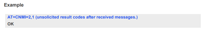

That seems a bad approach - how do you know that those texts don't contain stuff you need?
Why don't you just use the +CMTI unsolicited response to tell you when a new message arrives?
Not sure need some guidance, document for the SIM 7600 doesn't mention much.
The rules for storing received SMS depend on its data coding
scheme, preferred memory storage (AT+CPMS) setting and this
value:
0 – No SMS-DELIVER indications are routed to the TE.
1 – If SMS-DELIVER is stored into ME/TA, indication of the
memory location is routed to the TE using unsolicited result code:
+CMTI: <mem3>,<index>.
2 – SMS-DELIVERs (except class 2 messages and
messages in the message waiting indication group (store
message)) are routed directly to the TE using unsolicited result
code
What you've quoted is about storage - you need to look at notifications for when a message arrives.
Search the document for "CMTI" ?
Can you give a link to the document?
Thanks its mentioned once which is the excerpt above.
So give that a try.
As always, try this & other experiments manually on a terminal - don't try coding it until you've got familiar with it manually!
So AT+CNMI=2,1
+CMTI: "SM",0
+CMTI: "SM",1
+CMTI: "SM",2
Counts up as there are more SMS (x3)
AT+CMGD=0,4 now AT+CNMI=2,1 returns OK
So I need to send the SMS text 2424 with BAL then wait for AT+CNMI=2,1 to return +CMTI: "SM",0 or higher then AT+CMGR=0 and then filter the result.
Not quite:
AT+CNMI=2,1 enables the unsolicited responses - it's a setup that you only do once.
The +CMTI: responses then appear unsolicited - ie, without you having to issue a command to get (or "solicit") them.
So you send your message, then wait for a +CMTI: to indicate that a message (hopefully, the reply) has been received.
