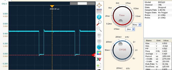

This is purely a guess, but since your sensor appears to have three wires, I am guessing it to be a hall effect sensor, One wire (black) for ground, one (red) for power, and one for output signal (blue). In order to read the RPM correctly you will also need to know the number of signals per revolution that are being output. The output signal is probably a square wave that looks similar to the one in the picture below. If you cannot find the specifications on the speed sensor (voltage output and number of signals per revolution), you should connect the sensor to an oscilloscope to determine the output. Once you know this information you can use interrupts in the Arduino code to count the number of pulses to determine the wheel speed. What car (make,model,year) are you using?
Thank you so much for all this info is there a way I can check all this using a regular multimeter? I also think like you that the black is for ground and that the red is for +12v and the blue is for signal. I don't have an oscilloscope that's my main issue.

Hi, thank you again for your help. I created a jumper cable for the blue cable to measure the output signal using a classic multimeter. While moving just a lit of bit the car I can see the voltage going quickly from 11v to 0v. I will attach a video showing this pattern. Do you know how I can manage this with Arduino?

You need to decrease the signal level before going anywhere near an arduino input with it. A voltage divider should probably work.
A better way would be to use an optocoupler, or just separate LED and photodiode. Add a resistor on the LED side.
Then you just count pulses per second coming from the photodiode/optocoupler output.
Are you sure you have the meter connected correctly? Your video shows the reading going from about -10.6v to -0.2v. I think this should be a positive voltage.

If you are getting +12v on the red wire, try disconnecting the connector from the vehicle vehicle harness and feeding +5v from the Arduino to the red wire, ground the black wire to an Arduino GND pin, then check the output signal on the blue wire. When you do this you should be getting a 0 to +5 (or just a little less) on the blue wire. You do not want to feed the Arduino more than +5v.

I am stuck figuring out how I can lower the 12v pulse signal to a 5v pulse signal for the Arduino without disturbing the signal
Thanks again
As was mentioned in another post, use a voltage divider.
Remember that the input voltage may vary depending on the source, so you need to design a divider based on the maximum input voltage.
Did you read @oldvetteguy's post? All you need is two resistors.
If you click on the wikipedia link in my previous post you will find a formula for calculating the value of the two resistors. If my quick calculation is correct, R1=180Ω and R2=100Ω should give you 5v with a 14v input, 3.9v with an 11v input.
