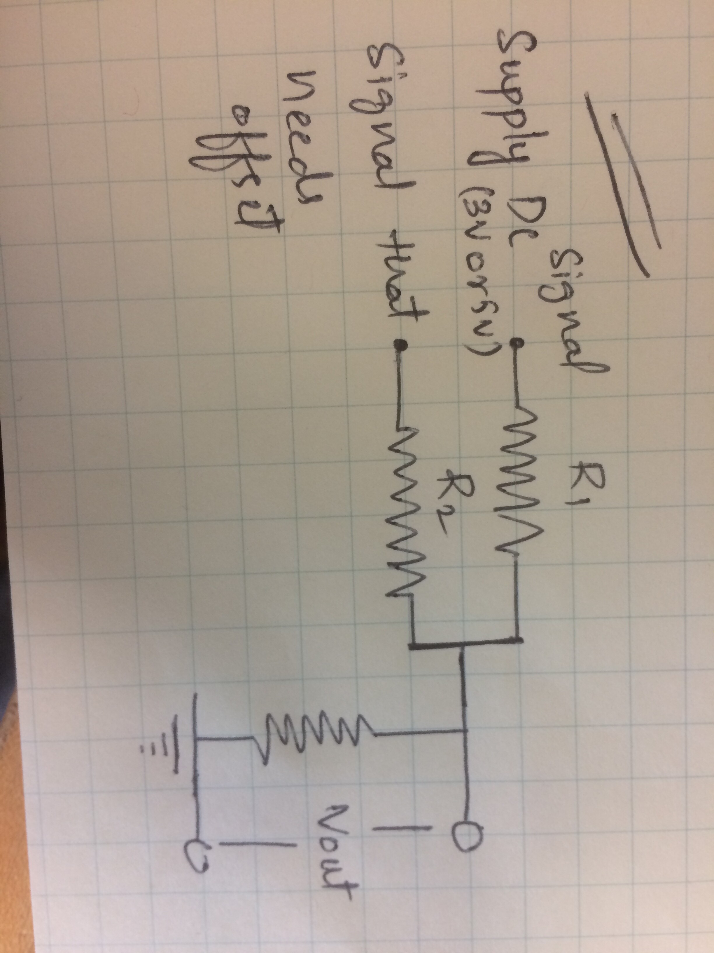

You can use op-amp if you have one. However, you can use the circuit that crossroads have mentioned.
It should look like this. In the attached circuit diagram, I have used R1, R2, and R3 as 220 omega for my project. you can tinker with these resistors values so that you can understand yourself what is happening. Get a feel for it.
A voltage divider and coupling cap won't work for DC signals.
A resistor network puts DC on the sensor output.
Only opamps could solve this problem.

Thanks for all the replies. I tried the circuit that meme suggested, but like some of you said it doesn't seem to work. I get a nominal value of about 1.65V, but the response I get from the sensor is much smaller than it was before. EDIT: It's also not dropping below 1.65V at any point, so I'm guessing it's still not receiving the negative half of the signal.
