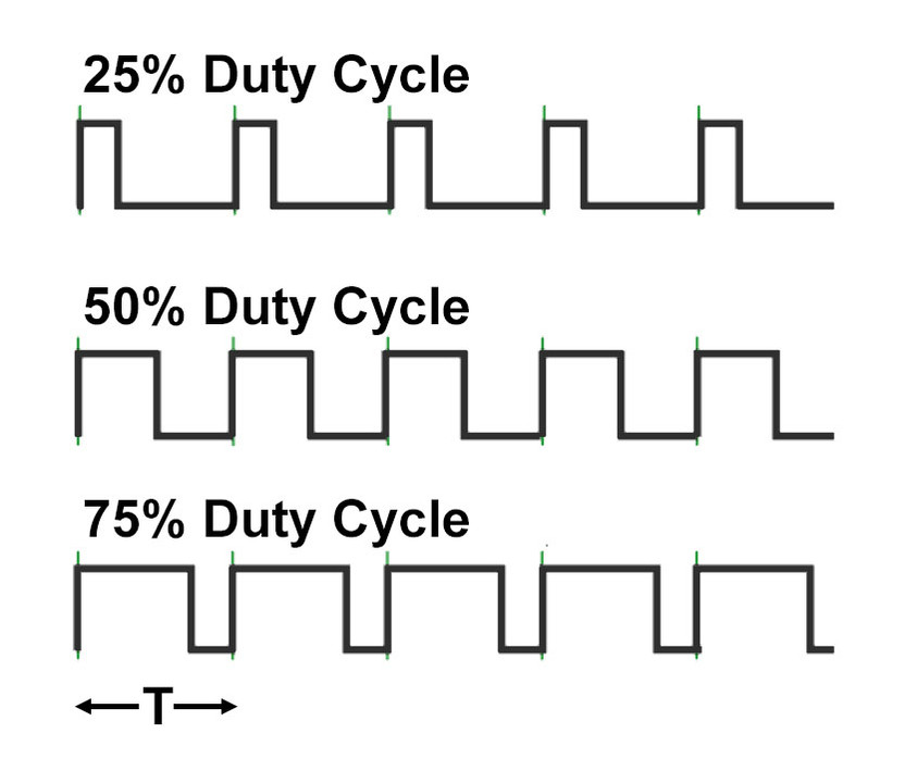

Do you know what a PWM signal is and looks like ?
The PWM signal that you are measuring is switching rapidly between 0V and 3V (after the potential divider).
When you do an analogRead() you are measuring the instantaneous value of the input signal, so it is always going to be either 3V or 0V (unless you happen to catch a rising or falling edge).
A multimeter works differently. It takes its readings at a slow rate and responds to the average voltage during its sampling period.
You can use a low-pass filter to average-out the voltage.

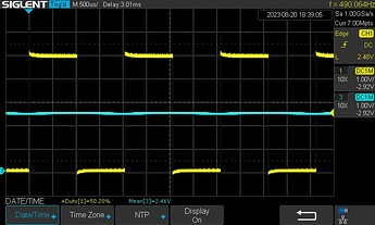

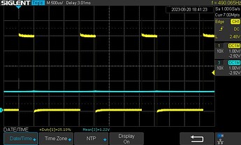

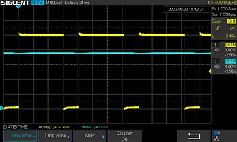

Using a low pass filter you can convert a PWM signal to a steady voltage.
1st_Order_Lowpass_Filter_RC.svg
Using R=10kΩ, C = 10µF
Yellow trace = Vin
Blue trace = Vout
25% duty cycle.
50% duty cycle.
75% duty cycle
