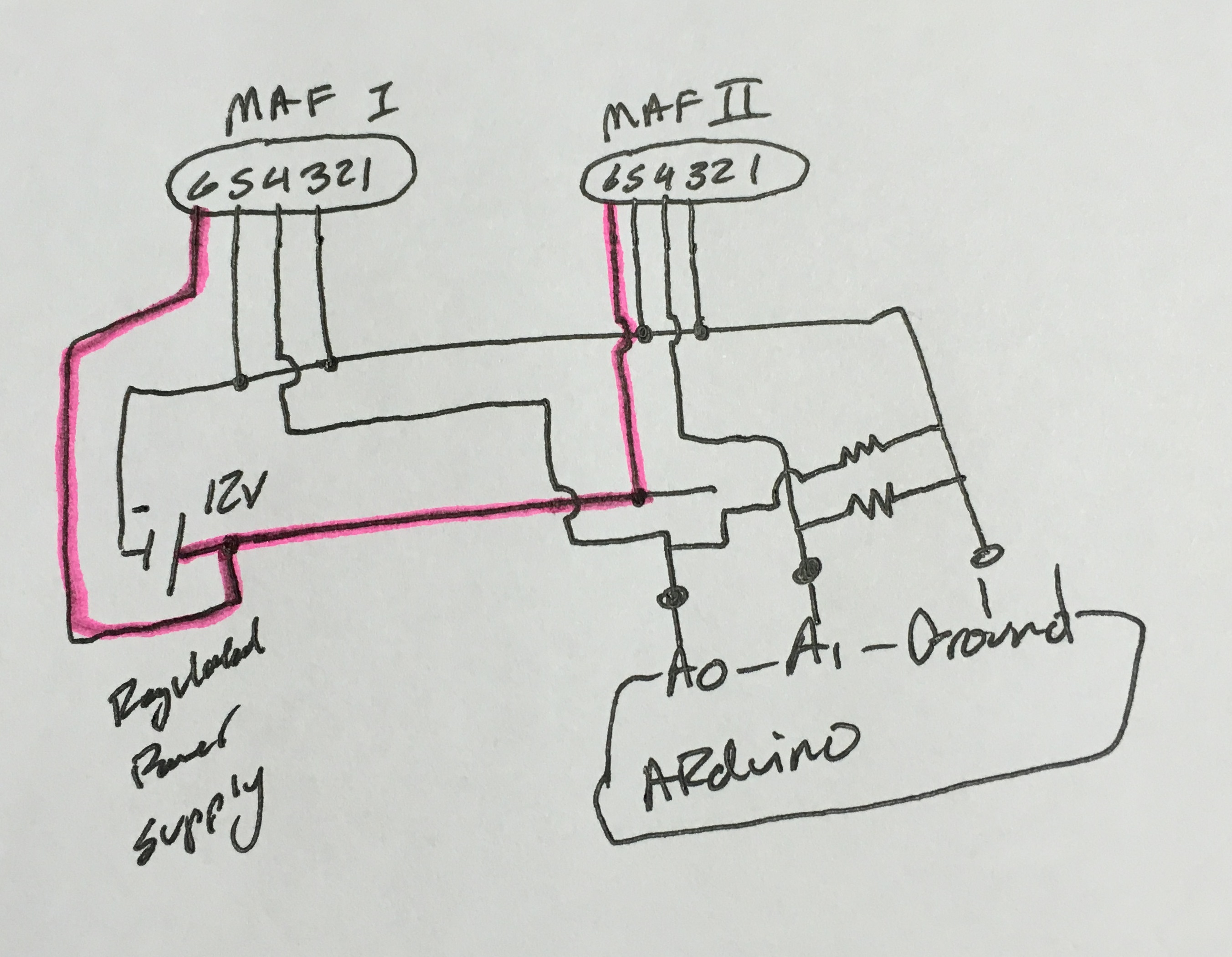

Hey guys im building a flow bench and would like to use a pair of automotive flow sensors "MAF" sensors.
I want to poll both sensors analog values and record them, But I am having issues with the wiring.
Here is the sensors internal diagram:

Here is the wiring on the sensor. We will be using pins 3,4,5,6.
Pin 6 will need 12v power. I will supply this with a regulated 12v power supply, pin 5 will go to regulated power supply ground
4 is the sensor return to the analog pin.
HERE IS WHERE I GET CONFUSED: What do I do for ground wires? tie all of them together?
Also inside the oem ecu they use pull down resistor on the MAF signal line. Do i need to replicate this for any reason? how would i?

So tie all grounds together? I dont understand why there are 2 signal wires? why does there need to be two grounds?
I mean should i just add pull down resistors across the single signal back to ground or something. I tried to do this like a year ago and nothing worked, im about to revisit it and trying to figure out where i messed upu the wiring.
I made a rough drawing
Your drawing looks correct to me.
The reason why you use several sensors (or actuators) for a specific purpose in embedded systems such as cars and planes is for rundundancy. If one sensor goes haywire, you most likely still have more sensors with correct readings.
