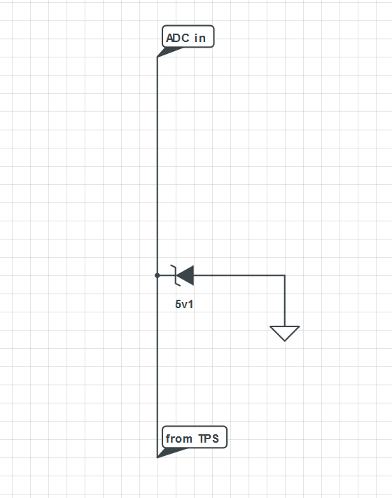

hello forum. i am in the process of building a simple diagnostic for my car.
all the sensors I have used to get info, are additional, so i haven't interfered with any of the cars sensors, expect 2 : crankshaft position and throttle position sensor.
crankshaft position : provides a 12v pulse, 4 times per engine revolution. i use a simple optocoupler, with 1Kohm resistor, to read that signal.
Thtottle position sensor: 0 - 5v proportional to how much throttle is applied.
I have attached the "Schemantic"... very simple....
so here is the problem : when i have the diagnostic connected, the car behaves strange. meaning. "i press the throttle, and the engine, either lags to rev up , OR it starts to rev up, then stops, then starts etc... "
i don't believe that the problem resides with the Crankshaft sensor, because i have done the same thing in previous version of the diagnostic, and all was fine.
so... i guess that the problem is , the way i read the TPS. i thought that the arduino analog input where high impedence, so it wouldent interfere with the car ECU...
any ideas?? thanks !
Schematic inline for others' benefit...
What's the voltage range on the TPS without the zener and disconnected from the Arduino?
If its 0-12V, you could replace the zener with a series connected 15K resistor which would offer 0-20VDC protection on the analog input. Could then add a 0.1µF (100nF) capacitor from ADC in to GND which will improve measurement accuracy and stability.
EDIT: Even if its still 0-5V, I would try the same thing, except using a 10K resistor.
Yep ! The output of the tps is 0-5v without my zener ! I installed the 10k resistor and it reduced the problem very much !!
I suspect that the problem is that my diagnostic , is inducing noise in the sensor (they are grounded in diferent places ... ) and the 10k reduces that noise...
But i still can see some problems.. (not much tho ) would a larger value resistor work better ?? ( i know that i would have to wait more for the analogpins to charge that way, but i am ok with that !!)
What else could i do ??
P.s : something stupid. Would a diode and a 10k i. Serries , from tps to A0 , solve this ?? ( and i wouls compestate in the code for the voltage drop )
Without a scope its hard to know. It could be that the 10K is to high. It could be eliminating the noise, but also slowing down the rise/fall time of the signal to much for communication. It might be beneficial to try a series 1K resistor, then lower value to see what works best.
Wrapping the power connections through a ferrite core will help to improve noise immunity.
I see.... BUT , the TPS is just a potentiometer... So i wouldent think that the 10k would slow tge rise of the signals ... :confused: would an op amp buffer solve it better ???

I think the main problem at this point is noise through the GND and Vin connections to the Arduino.
A ferrite core could resolve this ... 3-5 turns of the GND and the Vin wire through the core should be all that's needed.

It would provide a stronger signal and probably wouldn't let the noise through, but if the problem is due to noise on the power connections, the noise issue will remain. I would try using a ferrite core first ... its a common solution for this type of problem.

Without knowing the R of the pot or the impedance of the original sensor electronics, it could be that you are loading the vehicle signal by connecting your circuit.
If that is the case, try a larger value R to your input. As this will slow down your ADC, do a couple of reads before accepting the ADC value.
