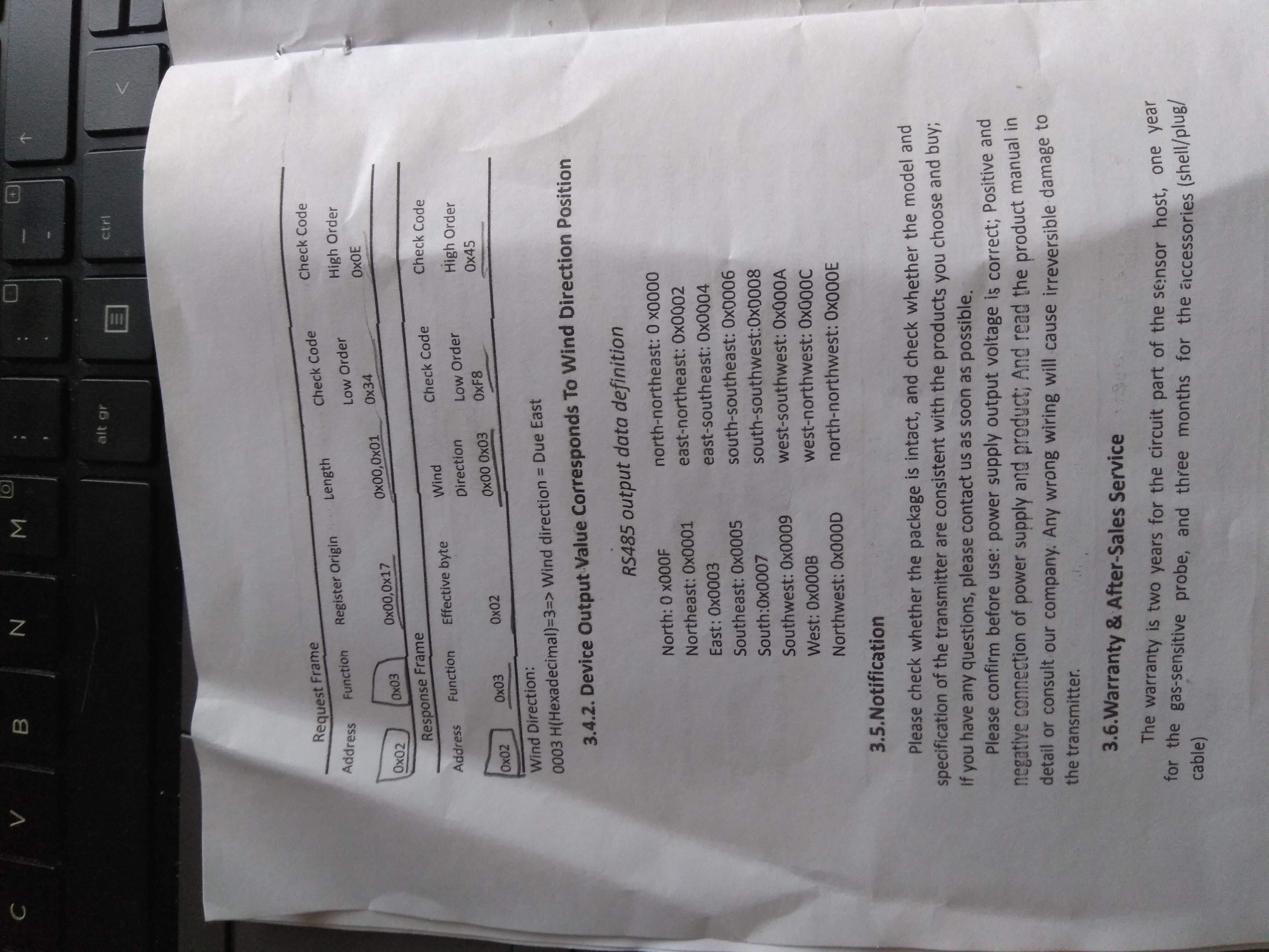

I want to build a device that can measure the direction of the wind. I decided to go with the following wind direction measurement sensor:
I found out that the device communicates with rs485 protocol, so I also got the following rs485 module:

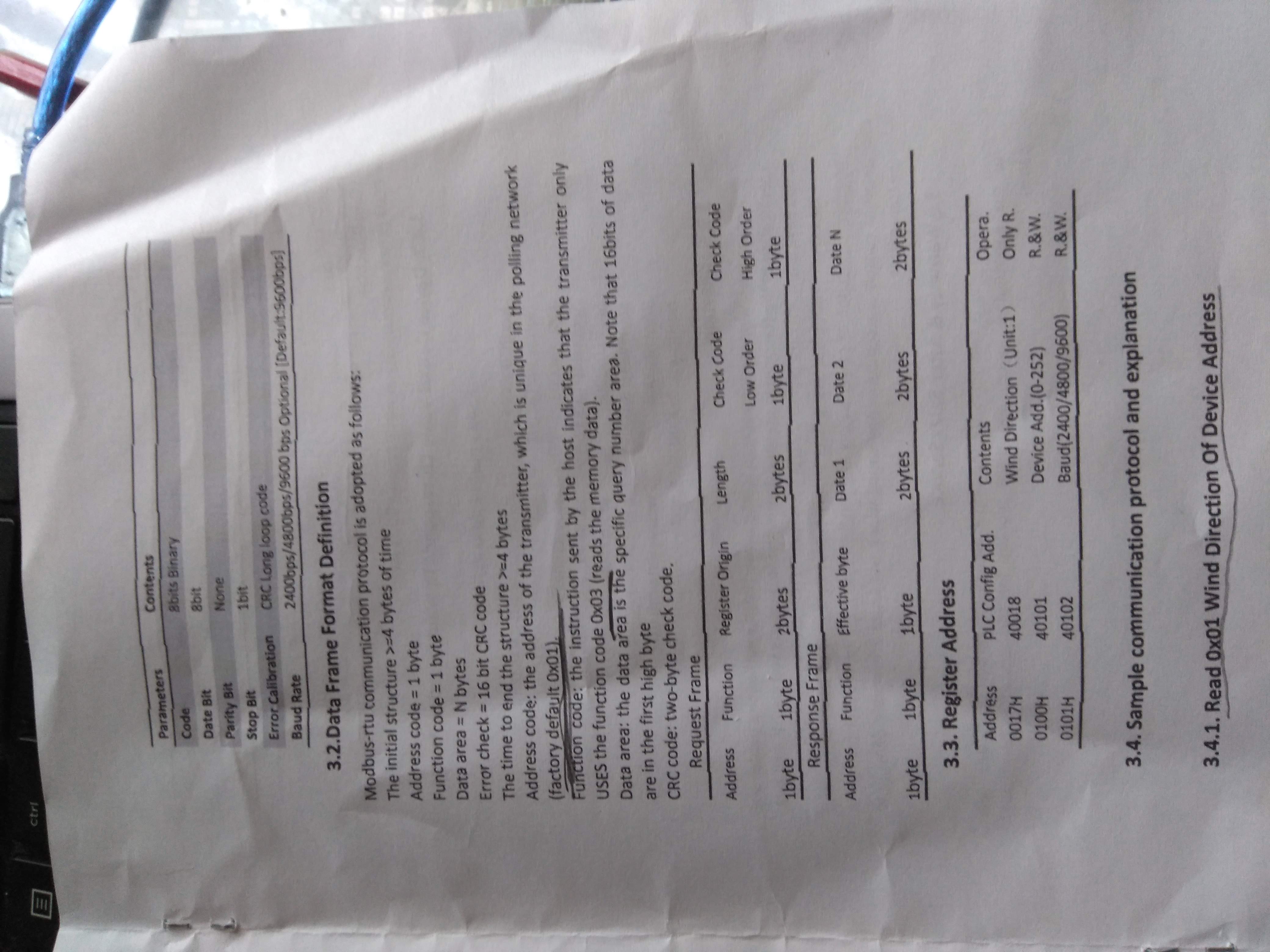

byte Anemometer_request[] = {0x02, 0x03, 0x00, 0x17, 0x00, 0x01, 0x34, 0x0E}; // request_frame

In the attachments, I have also added the manual for my wind direction sensor.
