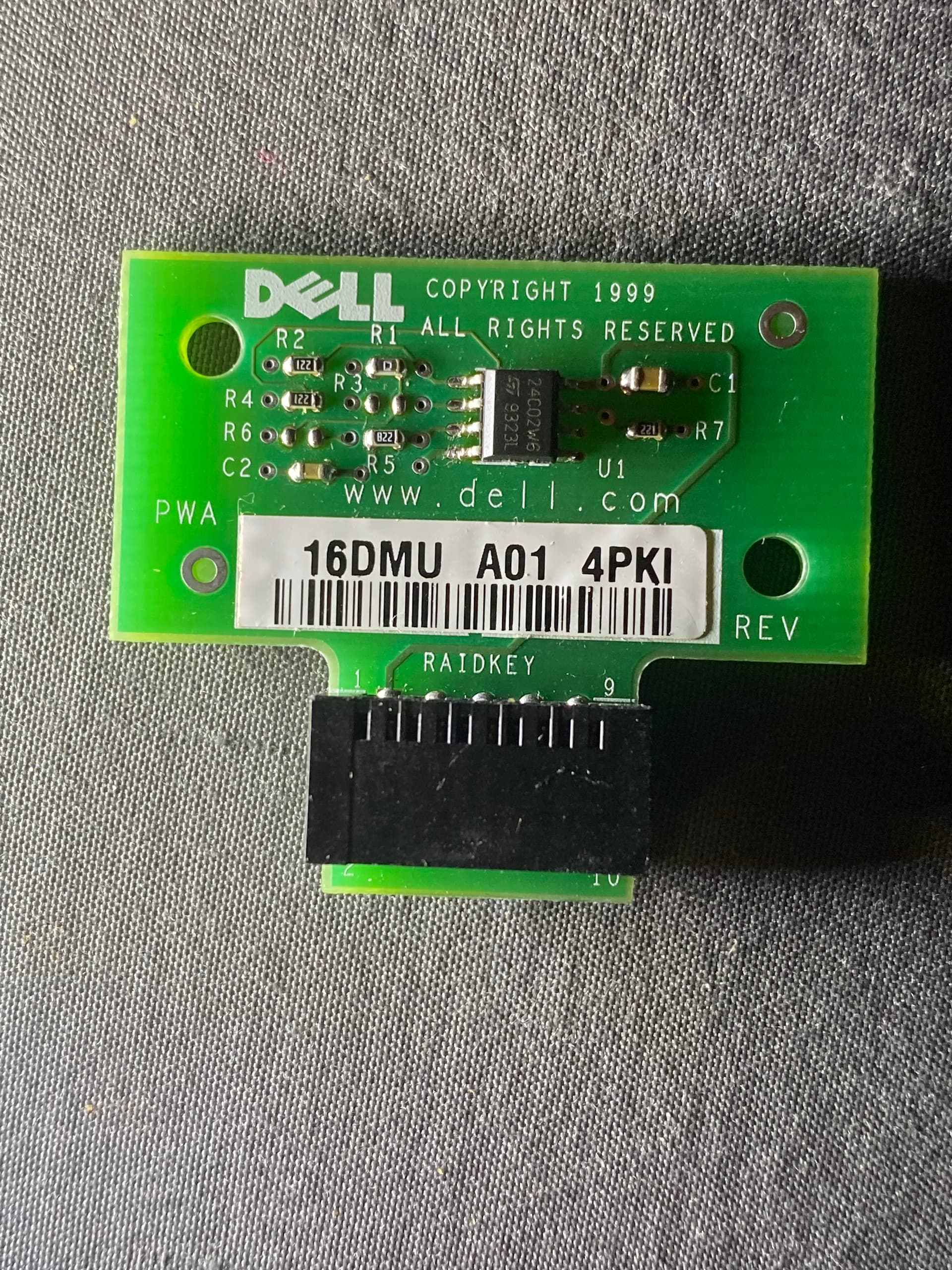

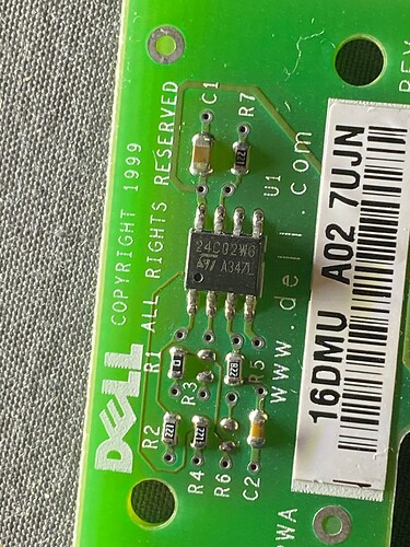

Hello I'm trying to read a External eeprom chip for it's address. It is a 24c02w6 chip that is a on a Dell PCB used for a Raid key. I'm not trying to copy whatever is on it. I'm trying to see If i can reuse it for other things. It has a 2k eeprom. I thought it would be good for something. Below is the Results of what the i2c scanner came up with. and Also images of the device. I have no other device on the i2c or attached to my arduino. Can someone help me to figure this out please?

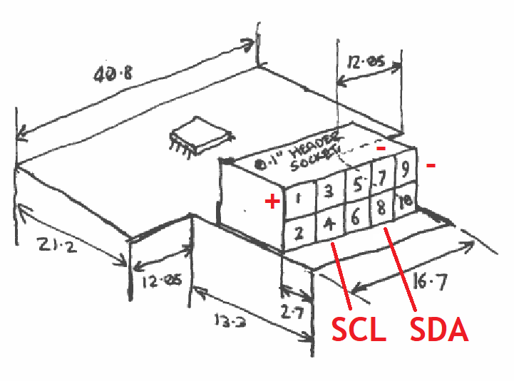

Hello John, From What I read on the site The pinout is Pin 1 is Vcc; pins 7 and 9 are ground. Pin 4 is Scl and Pin 8 is SDA They said. This Is the only thing I can find online. And they did a great job tracking down the pins with all the resisters ands capacitors on it. As far as the enable pin. Noting on it. I need to see that myself because There is no marking to indicate whick is pin one.

Hi @josephchrzempiec
To use an I2C BUS you need it to have pullup resistors.
FFrom what I see by the schematic shown that the board does not have these resistors, so it will be necessary to put the SDL and SCA.
Try 4K7 resistors.
The Arduino have internal pull-up resistors.
Well. Uno, Leonardo, Micro, Pro Micro, Mega, Zero and the SDA0 on the Due all have pull-up resistors. Only the SDA1 on the Due do not.
And this is more apparent that the SDA1 on the Due use I think the "wire1" library

I had tried to find a datasheet for it but couldn't find one. You would want one to know the expected behavior (e.g. what commands you need to send to read info, in what format, and what command is needed to write to the chip and stuff. Perhaps the chip is dead, for some reason. Like a power surge or something that took it out.

I2C is a protocol designed for on-board chip communication. Make your wires as short as possible (total length < 20cm)
Hi @cdr_xavier@josephchrzempiec
The values of the internal pull-up resistors are too high and therefore not within the I2C protocol recommendation.
Read :
"The value of Arduino (ATmega328P) internal pull-up resistors.
The inbuilt pull-up resistors on the Arduino/AVR outputs aren't well defined. When these are used, the exact value rarely matters - the datasheet gives a pretty wide range: 20kOhm-50kOhm.
There is a discussion on the official Arduino forum here, with a pull-up measured as R=30.9K from an effective voltage of 4.58V (which is different to the supply voltage). In short I measured the value on one chip as 34k from 4.6V, it will vary from chip to chip and even with temperature."
