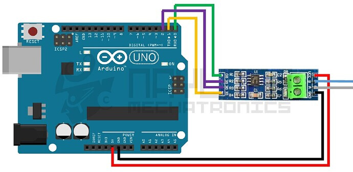

That's not what the fritzy thingy shows.
DI is where data transmitted from your ESP8266/UNO goes into the RS485 module. If DI is connected to D5, then SSerialTX should be set to 5.

Thanks @anon73444976 . That's what I explained just before the picture.

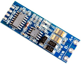

BTW, I also have this module...
I did some tests with this one and no answer either.
