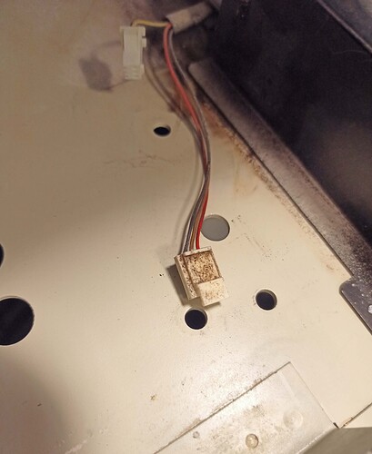

The cables connecting to the sensor is red, brown, black (see picture provided). There is a red light emitting from one sensor.
The adjustments for sensor reading will be on the metal piece that goes in between the sensor's transmitter/reciever.

The sensor itself, is 3 pins, black to the left, brown in the middle, and red to the right.
Ok, could only upload one picture.
The latest picture is where the sensor is "installed". The metal sheet has an opening and is usually closed.

Resistors must always be used, with both the emitter and the detector. If they aren't built into the sensor, you need to include them in the external circuit.
If you can't find the sensor data sheet, remove the plastic cover and post clear, focused pictures of all the innards.
It may be better just to buy a sensor for which the data sheet is available. Look for "optointerruptor" at any major parts supplier.

330 Ohm would give 12 mA into the LED which is generous.
The pull-up on the photosensor needs to be much higher, in fact about 47k would be reasonable but this is about what INPUT_PULLUP provides, so you should be able to use that instead of a resistor. As long as there is not too much distance between sensor and Arduino.
