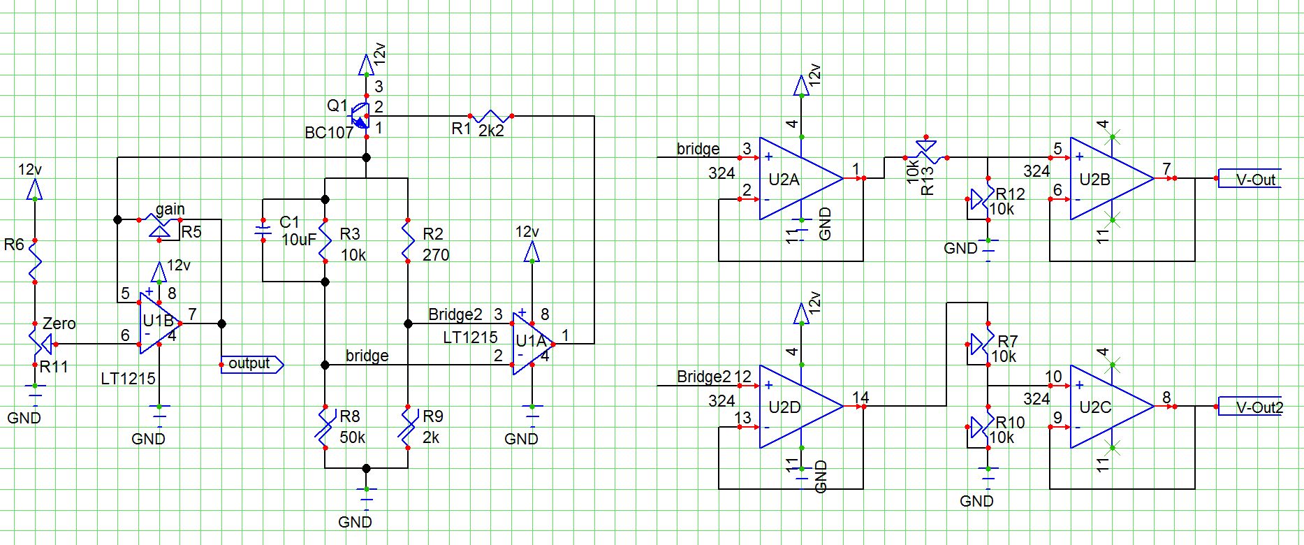

I am reading a web page with schematics and the author is no longer with us.
the page had a simple schematic but there are a few things I am not sure about
The left side has a zero and cal that are connected with what looks like a meter.
I am not sure if that is a physical connection.
Also zero and cal appear to be pots, again, not sure.
the note of U with the dot is only a test point for reading voltage in that part of the circuit.
lastly, there is a lone box on the left, possibly a resistor to set for a voltage divider for the zero pot.
this came from here : webpage
looking specifically at #1.3 internally heated NTC resistor bridge
Yes, it's a meter. That is the whole point of the circuit, an anemometer.
Since they use the same general symbol as every other resistor in the diagram, that makes sense.
Well, it is actually a functional junction point. The components on the right of it are the circuit which gives you an output whose voltage value is - as per the graph - proportional to your wind speed. Except that it has a fixed offset. The components on the left are whatever you choose to connect in order to indicate that measurement, given that you have to cancel out the offset.
The use of the BC107 in the feedback loop give it a very low output impedance which permits you a wide choice of indicators which is why the component values to the left of the junction are not specified; they are left up to you. Given that you are posting this in the Arduino context, you might be going to use an Arduino to do this by attaching a voltage divider to "U" to feed the analog input of the Arduino. Your offset cancellation will then be in software and your only concern will be to provide a regulated and stabilised supply of 10 to 12 V - though the use of the op amp and emitter follower is intended to provide substantial independence of the supply voltage and it is only the offset voltage divider that will be affected by fluctuations. If the offset is corrected in software and you are not using the left hand side of the circuit, then it is only the ADC reference which needs to be accurate.
this came from here.
Looks like a resistor, quacks like a resistor ...
Its presence implies the expectation that the offset voltage on "U" will be less than half of the 10 V. 4.5 V in fact according to the graph:

since my goal is to connect it to an arduino or an ADC of some sort, the reading at U would be what I could use.
Sounds like I would be well served to put that signal into the other half of the op-amp. Then add a zero and span adjustment for my needs.
Since the Analog inputs are 10 bit, I will want to try to use as much of that as I can.

Admirable intention, but the offset represents only one bit on the ADC and the accuracy of this device is no better than perhaps 5% (six bits) at the very best imaginable.
My goal is not high accuracy, but more of getting the output to fit the 5v span of the ADC.
This is more of a 'flow proven' sensor for an exhaust fan of a greenhouse.

based on the graph, 0 to 20 m/s is about 4,000 FPM, or a VERY high power blower.
less than 1,000 FPM or about 5 m/s is closer to my goal. 800 FPM is my expected high speed fan output.
the output is logarithmic, so I hope to get a higher sensitivity in this range,
and more hope, that the 1+ volt output [per the graph] can be coaxed into something useable into an ADC.

Nice thread. But one question is ------- why is that BC107 transistor (in the diagram) drawn in that particular way?
I had never seen that particular symbol for a transistor before that schematic.
I do believe the the gentleman who created that site was self taught and used that symbol from either an older diagram or from some other, possibly self-created source.

Not self-created.
You pointed out that "the author is no longer with us". The symbol hails from the 1960s according to this reference:

Voltage divider drops 10 V to 5, your range is now 2.5 V to 5 V, you lose only the MSB.
