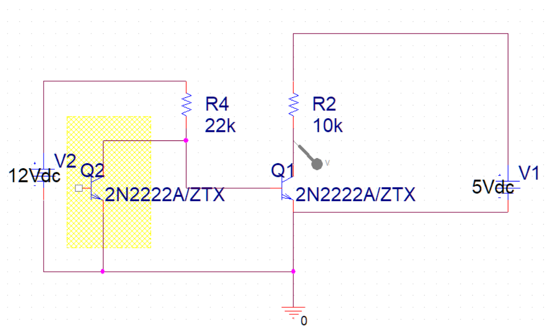

I didn't read this Intel doc so thx for the findings! Intel recommends pull up to 12v, whereas I originally connected pull up to only 5v. I tried the following experiment with the following schematic:
(The grey probe is where Arduino ISR pin attached to, while yellow part is internal to the fan)
Original (schematic A):
This above is my original setup, and has encountered several problems as described in original post.
This schematic B below is my modified setup with the Intel doc, trying pull-up to 12v instead of 5v, and added a 2n2222a to change to 5v signal.
The situation has indeed improved: using B, one of the models which only reports correct readings with duty either 0% or 100% in schematic A now reports as expected with all duty. Nice!
However there's still a fan model, that reports all over the place (ranging from several hundred to nearly 10k) in schematic A, continuing to act weirdly in schematic B.

You dont need to pull up to 12V to get a 5V signal.
However as I said the 22k is probably much too large.
Change your first circuit to use a 1k or 2k2 resistor and I bet it works fine.
The high impedance could be allowing interference from the adjacent PWM line.

I had tried schematic A (tachometer open-collector pull-up to 5v) with 1k pull-up resistor but the one particular fan (let's call it WF for weird fan) still goes haywire reporting nonsense, thus I tried schematic B. Most of the fans are fine with B while the only misbehaving remained is again WF so I settled with schematic B that day.
Now that you've mentioned it again, I checked again schematic A with different pull-up resistor. This time I observed more closely and discovered that with 1000 ohm, though WF readings are still jumping around for most of the duty ratios, as long as the resulting RPM is below like 1700 or so then it's indeed reporting correctly (on this specific model, around 35% duty). I went ahead and go even lower on the pull-up resistor and tried 220 ohm, and this time WF with schematic A i.e. 5v pull-up reports correctly up to around 2500 RPM (correspondingly 61% duty), which is nice. Though this fan is rated at 3300 RPM and anything above 61% duty the readings would still go haywire and starts jumping around by several thousands.
An interesting thing I observed is that as long as I physically touch the 220 ohm pull up resistor with my fingers, WF reports correctly for around 1% more duty (my code specifies granularity of 1/80 so it's around 1.25% to be specific), so I guess the issue does involve some interference here.
I tried also even lower pull up resistor, like 147 ohm (100 + 47), with schematic A. The variation of the readings remain small up to 79% duty (around 3200). But unfortunately the readings seemed to start drifting away from the truth even when the variation of the readings remain small: if I were to again physically touch the two pull up resistors (which are in serial), the readings are down by 200 to 3000, which I believe is a more accurate measurement of RPM based on the sound profile of the fan and the fact its max rated RPM is 3300 and there's still like 20% duty from 100%.
I can't go lower though: with 100 ohm schematic A the fan WF itself starts to ignore some lower duty signals i.e. if I were to set the duty ratio too low then the fan just ignores the signal and would not spin any slower.
Currently I settled with 220 ohm pull up schematic A; the WF model respects duty input and reports tachometer mostly correctly up to 61% duty or 2500 RPM, and all other models are working as expected.
