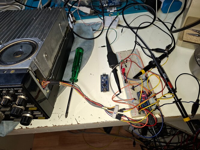

I am currently working on a project where I use an Arduino Nano to decode and encode CTCSS codes.
I want to set the CTCSS code selected by the transceiver, an Icom IC275H. Serial data, clock and latch, are available for this. I created the code below that reads the sent data.

On the scope the signals look like this:
Yellow = Data
Purple = Clock
Blue = Latch.
The data decoded as 154 corresponds to the 77Hz sub audio setting
The problem is that not all data is read by the program, probably because the latch is only high for 4.2usec and is not compatible with the SPI protocol. So if I select a CTCSS code on the transceiver, it skips settings.

I have already done that and works fine. But as you can see from the scope image, the latch signal goes high after the data is sent, which does not match the SPI specifications. It would be nice to read the data in a different way than with the spi function. but I'm afraid I would have to use 2 interrupts for this. Namely for the clock and for the latch.
If the Clock is not faster than digitalRead();
Ignore the Latch , just read the Data after every Clock ,( Bit bang).
Play around with the timing after the Clock is detected High or Low , Data transition on High or Low?
Hello mike,
If I ignore the latch, I do get all the data. But also the other data that goes over the serial bus, and is therefore not relevant. So the latch pin functions as a chip select.

Sure is. I have it working, but the only problem i stil have, is that the arduino does not follow the chip-select. So I get all of the data from the serial bus, not only the 8bit data for the CTCSS frequentie.

Thanks for pointing me out. Just discover that i have spikes of 1 volt pp on the chip-select output, when I turn the VFO dial on the transceiver. Maybe that is causing the problems.
Not that strange considering the setup HI.
