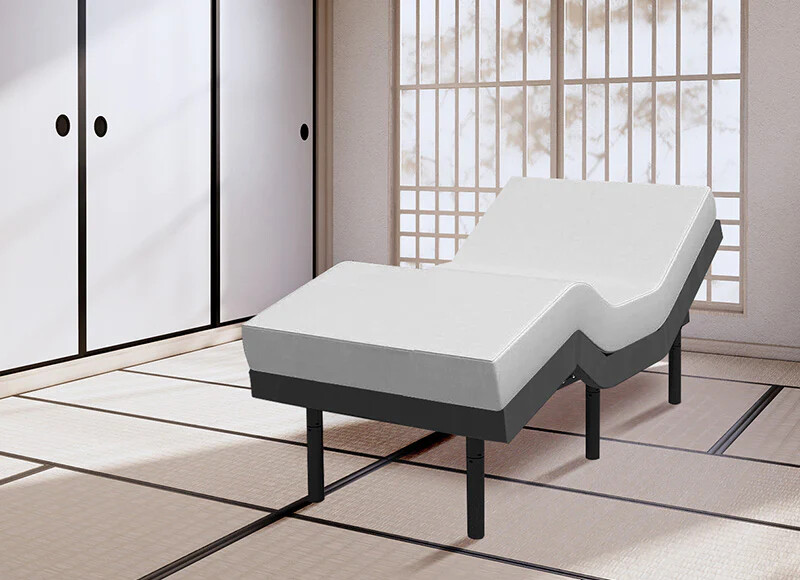

Hi Tom,
it's something like bed, that can be transformed to "chair" and also tilted in some way, I am doing just motor controls, it's actually someone else's project.
T

Something like this?
