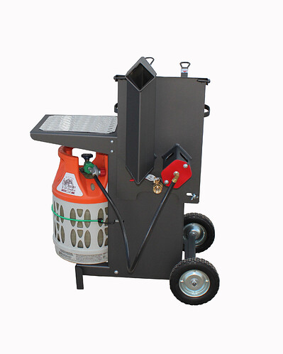

According to google, a propane flame is around 1900 C (3452 F). The flame shoots into a tube that is 57" long and I am trying to monitor the temperature of the tube at the opposite end of the flame.
I do know, it maxed my little thermometer out at 600+F degrees but I have no way of really measuring.
Do they make a thermometer that will work with the arduino that will measure this high of temperature?
