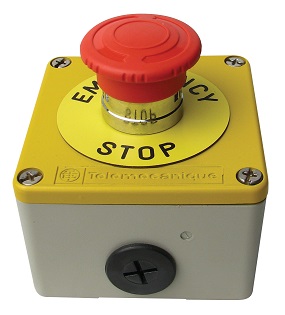

Get one of these:
A jumper placed at the right point in the circuit would cost $0.03. Probably less in the quantities they make Arduinos.
