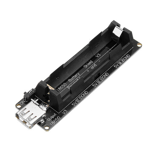

There are modules out there that allow for USB charging and using the battery for power at the same time.

There are dedicated charger ICs for LiPo batteries. A fixed resistor sets the charge current (based on the battery capacity), the IC takes care of current control and charge control - regulating current, cutting it off when the battery is full, etc. No doubt the device in #2 has one such chips, probably on the back of the PCB. How they do that exactly I don't know, that's for the charger specialists.
