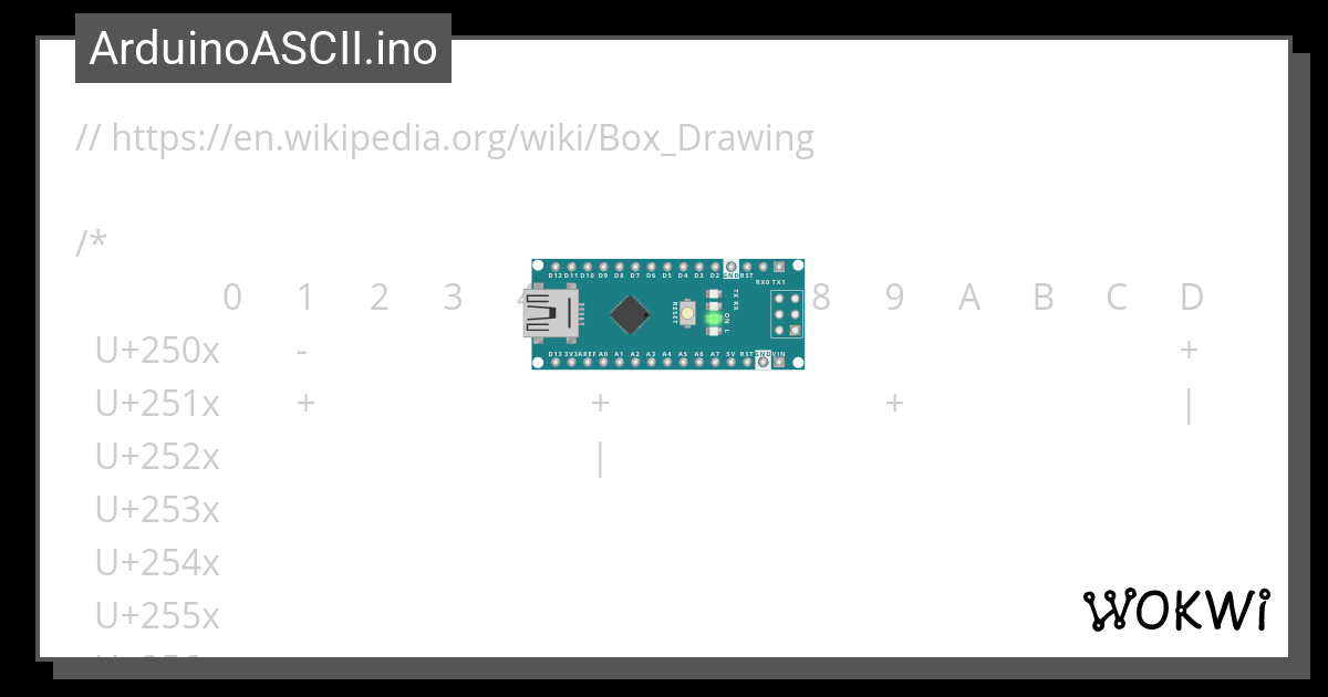

ASCIImatics - will never be made redundant.
            │ESP32 WeMos│
            │  D1 Mini  │       +------------+
            │RST      TX│       │POWER SUPPLY│
            │A8       RX│  +----│GND         │
            │D0       D1│  │ +--│5V          │
  +-----CLK-|D5(14)   D2│  │ │  +------------+
  │         │D6       D3│  │ │
  │ +--DATA-|D7(13)   D4│  │ │
  │ │ +--CS-|D8(15)    G|--+ │
  │ │ │     │3V3      5V|--│-+  +-----------+
  │ │ │     │           │  │ │  │MAX7219 8x8│
  │ │ │     │RESET      │  │ +--│5V       5V│
  │ │ │     +-----------+  +----│GND     GND│
  │ │ +-------------------------│CS     DOUT│
  │ +---------------------------│DIN      CS│
  +-----------------------------│CLK     CLK│

IKR?! The beauty of simplicity. Blinding.
What is IKR?
Early PLC ladder logic used the same technique.
The acronym of, "I know, right?" It is how the kids say, "I agree with you."
