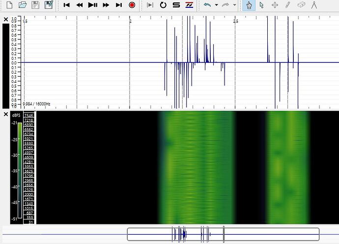

I would like to use a digital I2S microphone to record audio and store it as wav on a PC, preferably over serial connection. I have tried this with the boards ESP32 dev kit v1, MKR Wifi 1010 and Adafruit Feather M0 in combination with the microphones SPH0645 or INMP441, but never succeeded.

The above setup with the ESP32 dev kit v1 and the SPH0645 results in a wav file with the correct file structure (44 byte header etc.) but a signal that doesn't show the expected amplitudes and spectrogram features. It rather looks interrupted and distorted (see image).
Has anyone tried this and could help me figure out the correct hardware and code setup to achieve a successful recording?
Cheers!
You didn't say, in what way. In other words, you didn't give us any problem report.
Also, you report using various different hardware. Yet you post only one sketch. Which hardware does it belong to?
Did you test the different functions of each configuration using only simple test sketches, such as library examples? For the microphone, for example?
FYI, "exemplary" means roughly, "excellent". Did you mean, "example" codes?
Thanks for the response. I edited my questions a bit. I use exemplary in a less popular sense - sorry. https://www.merriam-webster.com/dictionary/exemplary
How do you know what to expect?
If you play back the recording as audio, does it sound like the original signal?
No, it doesn't. I would expect a continuous background noise and a set of signals characteristic for percussive sounds.
Get one thing working at a time, using simple, easy to interpret tests.
Test the recording process by calculating an audio frequency (e.g. 1 kHz) sine wave as data, and make sure that is recorded faithfully.
Test the microphone using your PC as an audio sine wave signal generator (lots of free programs available for that) and just LOOK at the raw waveform.
