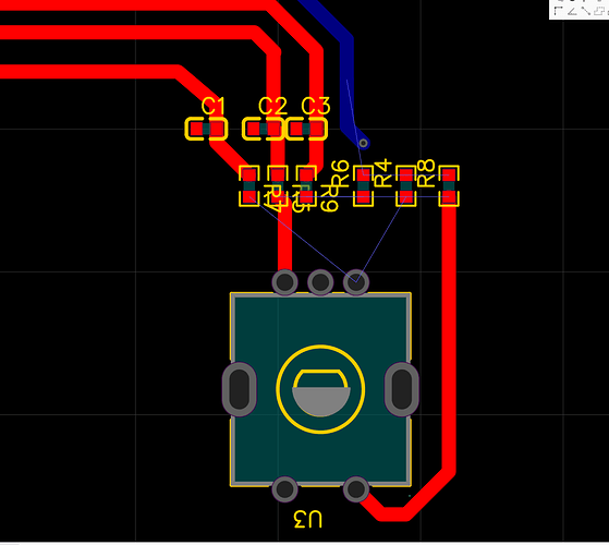

When I designed my PCB, I went all in with resistors and capacitor for de-bouncing and pull up. Though if not doing hardware de-bounce (which I highly recommend since you are designing the PCB and those surface mount resistors and caps are dirt cheap) you would do input-pullup on D2,D3, D8. Pin2 (or1) of the PEC11 should go to GND, not VCC.

I have attached 2 circuits. The first one is basic de-bounce:
R1 is the pull-up resistor. R2 is to reduce the discharge current out of the capacitor to ground when a switch is closed. The exact values don't matter too much, but typically R1 of 10k and R2 of 1k to 10k work well.
C1 can be 0.1u to 1u. The larger number will give a longer time constant.
The second circuit has all the bells and whistles, including a Schmitt trigger IC (cheap) for sharpening up the output transitions.

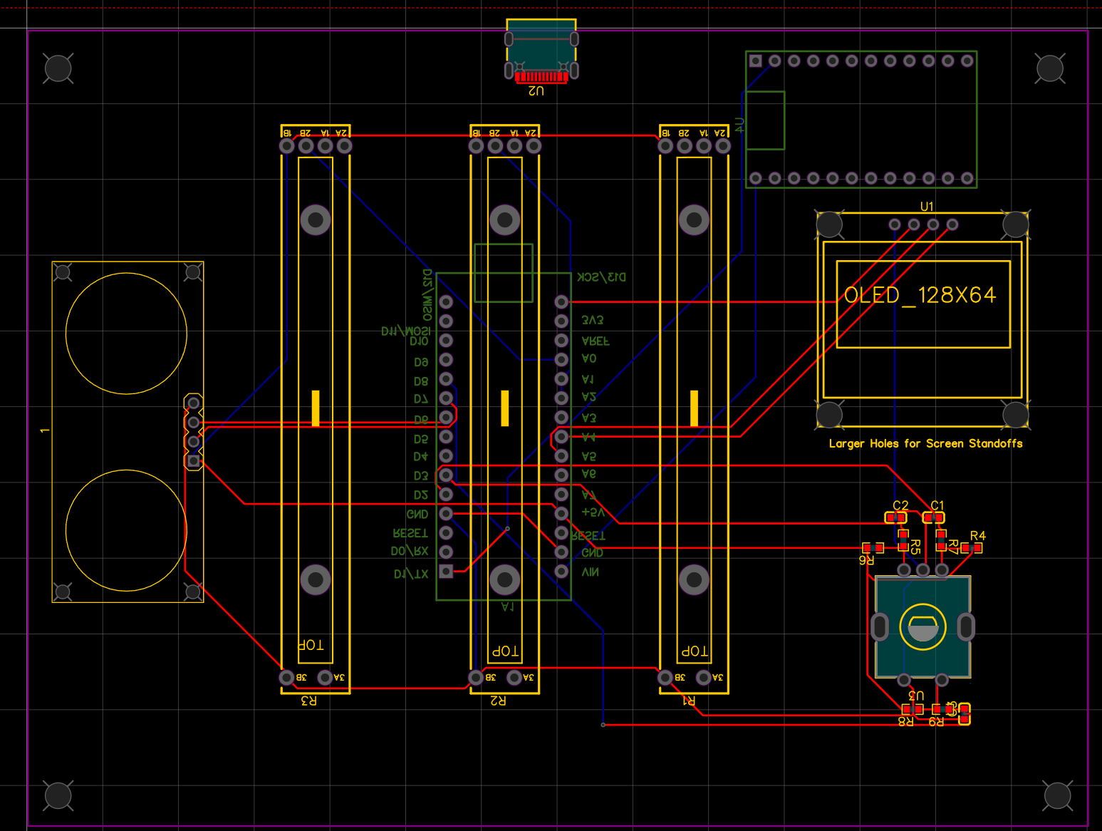

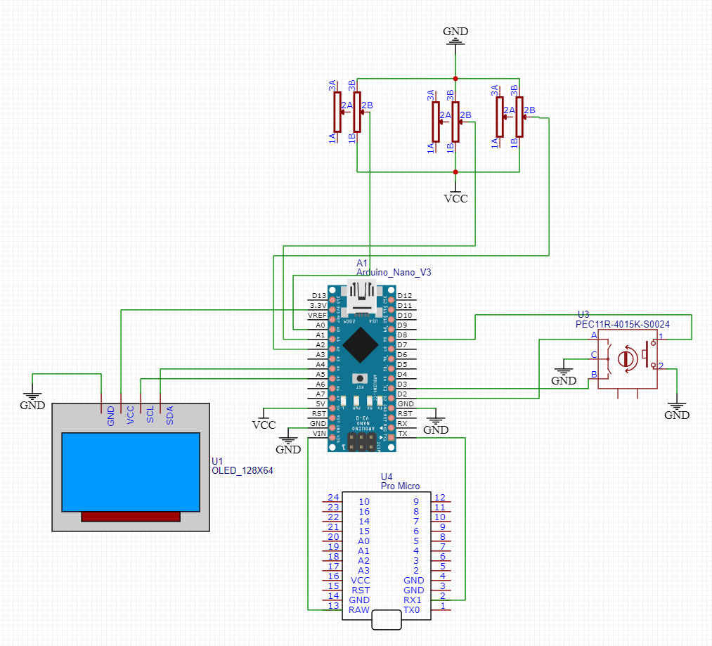

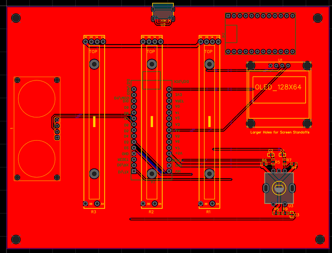

Thanks a bunch for all of the help so far. I've attached a screenshot of the current design.
(FYI the NanoEvery is doing all the heavy lifting and sending MIDI info to the ProMicro which acts as the Native USB Device).

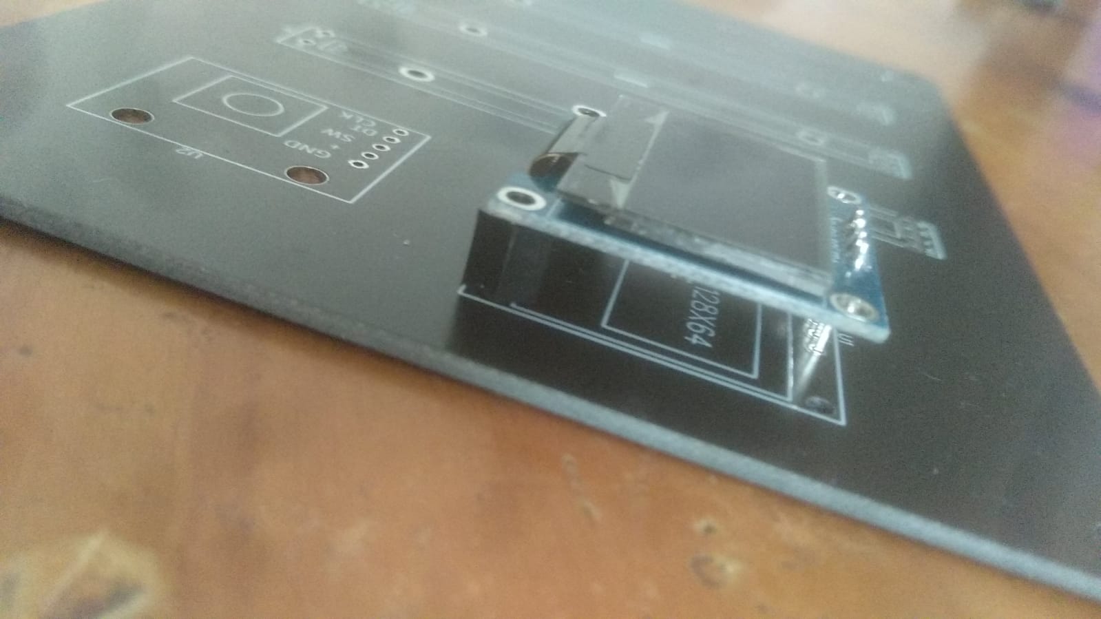

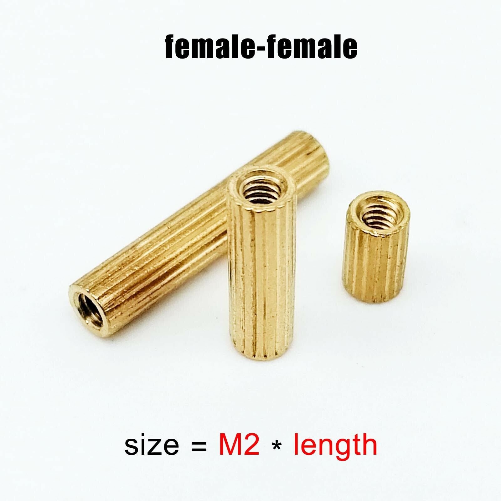

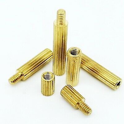

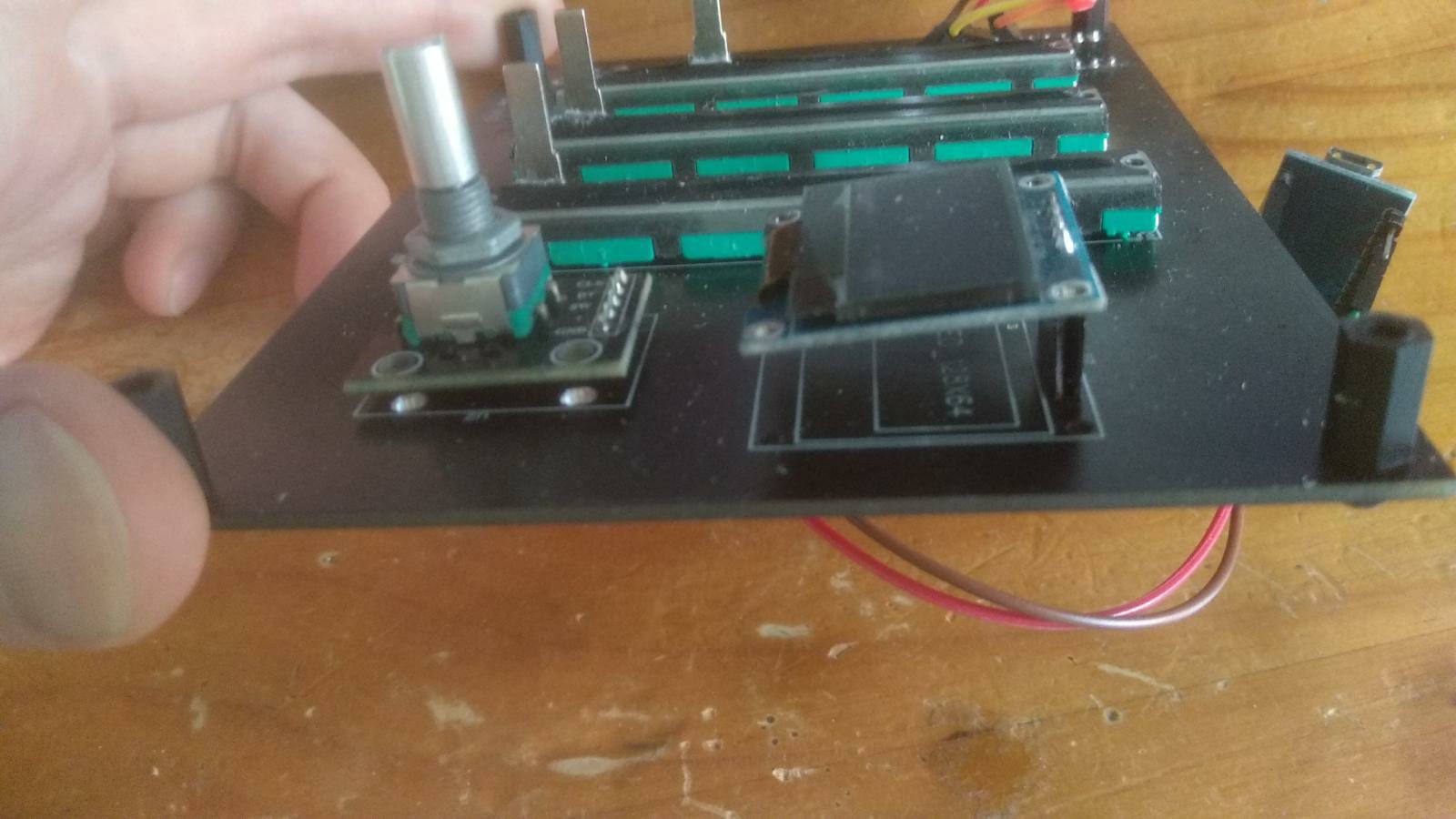

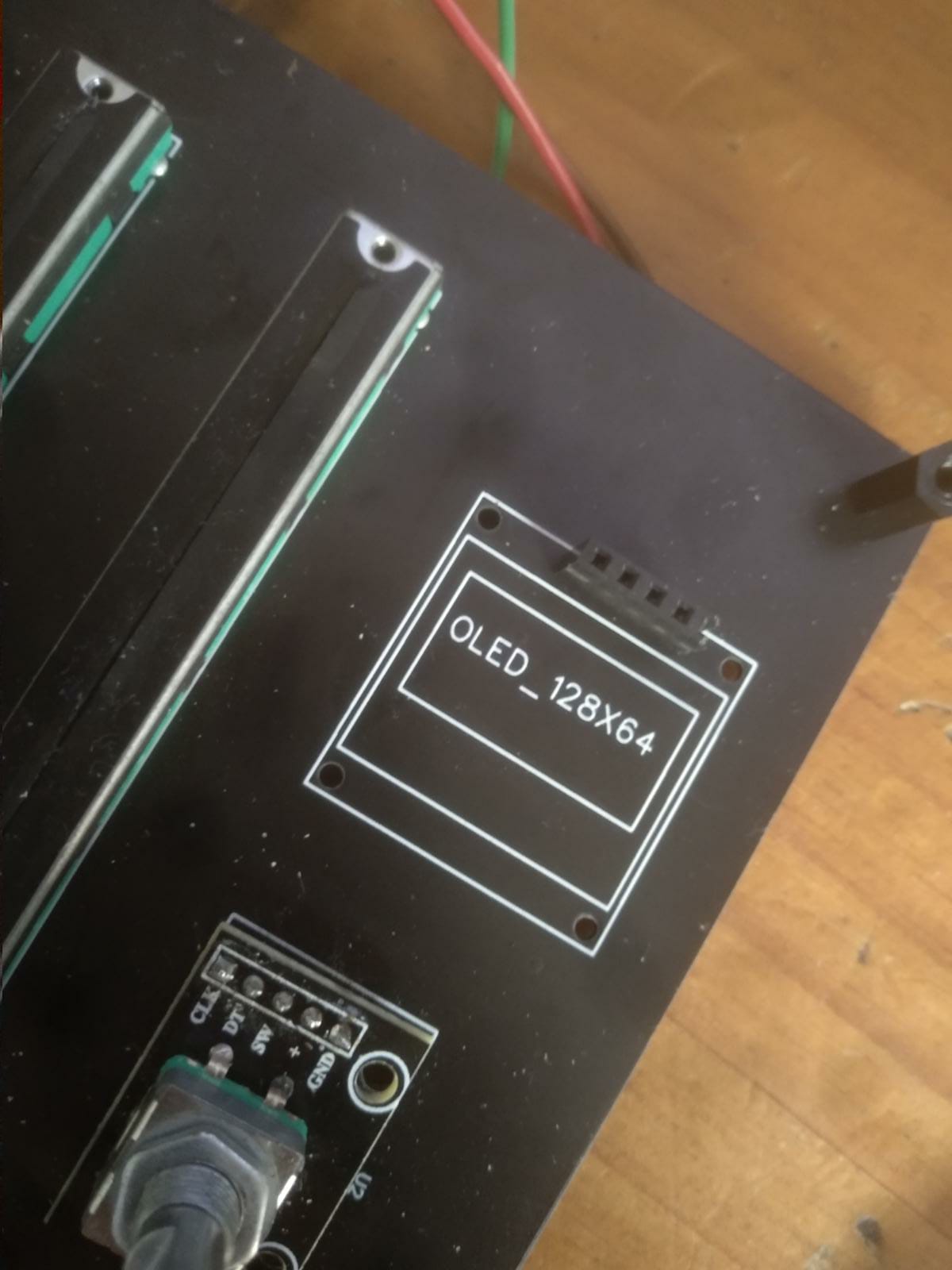

The first one is the OLED display. I'd like to mount it a bit more securely, but I dont want to mount it to the top-plate as that should only be added as a "beauty layer", and not add to stability.
This is how I currently have it attached (not very elegant - just floating in the air):
How would you normally go about stabalizing something like this?

Instead of having to redesign the whole board why not use the existing design and use SMD to DIP adapters
Appreciate your posting the entire diagram. It helps a lot.
One correction:
The PEC_A_Out is the connection to the Every pin D2. The PEC_A is connected to the PEC11 rotary encoder. The same applies to the B and SW net ports too.
There are a couple of options for the OLED.
The hard way would be to find an appropriate module on JLCPCB.
The easier way, but still a little hard, would be to create a footprint for the OLED on your PCB and solder it in yourself:
  • Measure the mounting holes in the existing OLED (diameter and spacing)
  • Place pads on the PCB in EasyEDA with the above dimensions and spacing
  • Add a 4-pin header to the schematic (Commonly Library/Connectors, and choose 2.54 mm spacing). Place it on the PCB where the OLED 4 pin header goes
  • Double-check with 3D view to make sure that you really do have holes at the pads and the header
  • Do NOT order the header when going through the parts list at the final stage of the ordering process. This will give you properly placed holes for the OLED
  • Mount the OLED using short standoffs and solder the pins into the holes where the header would have gone. You may only need the lower two holes to have standoffs. Snip off the pins flush to the underside of the board.
    This is a lot more complicated to describe than to do :slight_smile:. It will give you an OLED display that is fairly flush with the board.
I think that with all this and the encoder mounted to the board, your project will look very nice.

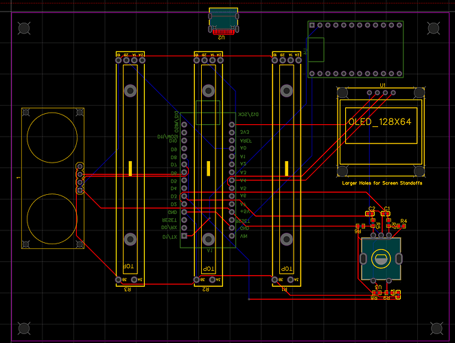

This should now hopefully be correct (?):
Maybe I'm misunderstanding what you mean, but isnt what you are describing, what I've already got going (in regards to the PCB)? If I understand correctly, I just need to remove the current header and add stand-offs to the 4 screw-holes and solder the OLED pins directly to the PCB, correct?

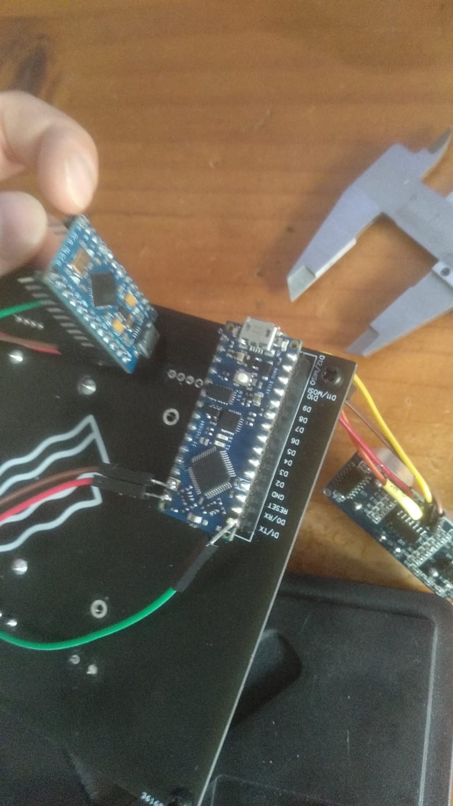

Basically like this, just with correct stand-offs (I dont dont currently have fitting ones on hand):
I was panning on soldering it onto the board, just like I did with the NanoEvery (in this case I added some headers so I can remove it for Testing purposes as I am still in development).
The ProMicro is currently only connected via some jumper wire (while I sort out the PCB design).
The Pro Micro is currently connected via the USB connector and delivers power to the NanoEvery via the RAW pin (AFAIK its some kind of direct-passthrough of USB power). Additionally I have the GRD and RX Pins connected (receiving MIDI data from NanoEvery).

EDIT: Is there a "best practice" when it comes to the layout of resistors and capacitors? I'm struggeling with the layout on the PCB. Looks very messy, and I cant seem to get the VCC connected to the Via (software doesnt seem to let me).
EDIT2: I found out there is an "Auto Route" option. If only I'd known that 6months ago when I did the first PCB :rofl:
AFAIK now all I need to do is get the USB-C connected :face_with_monocle:

With low frequency parts (the encoder will not be turning at 1000s of RPM, the layout is not critical.
I would just group each pin's components close to each other.
Are you using a ground plane (copper pour)? That is well worth doing, because it will simplify your layout,
In EasyEDA, you don't need to get a precise outline for copper pour. In the PCB layout, select the dashed rectangular tool from PCB tools palette. Select the bottom copper layer. Just draw an area larger than the PCB, and it will fill all the unused bottom layer with copper. A tip: the dashed lines you draw will be red even if you have selected the bottom layer. But as soon as you complete the polygon/rectangle, it will turn blue.
I will often do a copper pour on the top layer for VCC. Again, select the top copper layer and the dashed line tool.
If you do auto-route or move your traces, then jut re-pour the copper and everything will look right again.
Some other thoughts:
  • Make sure you rotate all your silk labels to be the right way up. Will look more professional :smile:
  • The labels should not be on pads
  • Don't forget to use the bottom silk layer for things like your board name, date, revision no, etc

Yes, I just had it turned off so you could see the top and bottom tracks. This is what it currently looks like (Copper Layer for GRD, that's the usual way of doing it, right?).

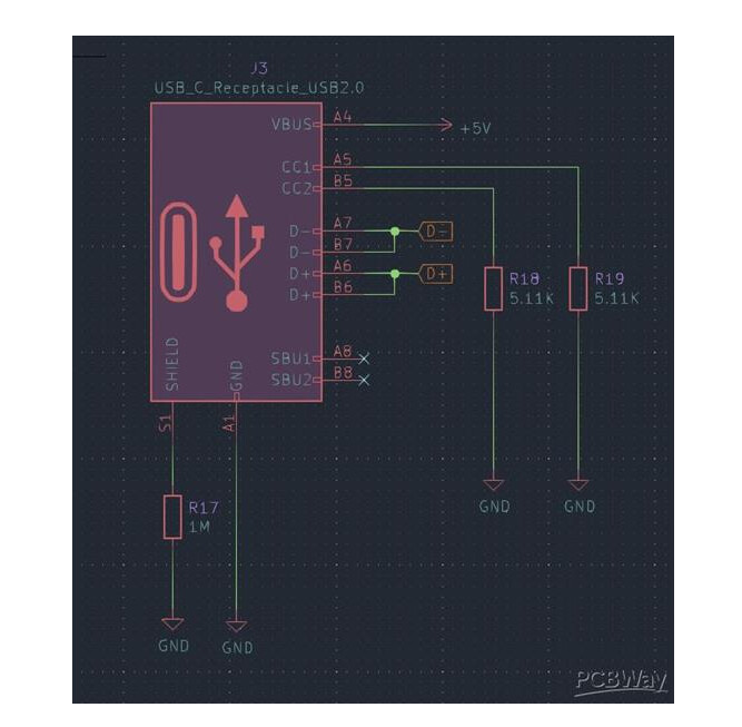

Do you have any knowledge in regard to connecting USB-C? AFAIK the required pins are Vbus, D +, D-, GND, CC1 and CC2.
From my understanding:
VBUS -> VCC (5V)
GRD -> GRD
CC1 -> 5.11k resistor -> GRD
CC2 -> 5.11k resistor -> GRD
D+ -> ?
D- -> ?
can you confirm the above, and do you know what to connect D- and D+ with? Are those the RX/TX pins on the ProMicro or something completely differnet?
That looks fantastic!
The copper pour for the ground looks good too. I have used the top copper for V+ pour, and this has saved me some vias.

Here is a schematic I found:
Take a look at it please. I think it is going to be very hard to do a direct wire.
As you can see, the USB D- and D+ go to the 32U D- and D+ via a resistor each. The diagram says 22 ohms, but I would double check that value.
It would be easy enough to add the resistors to your PCB. What I don't know is if the 32U D- and D+ pins are accessible and/or easy to hand solder to.
Thanks, I just stumbled across the schematic aswell. It doesnt seem like the pins 3, 4 on the 32U4 (D-, D+) are available on the Pinout of the ProMicro :confused:
Then again, my end-goal was to have the chips soldered onto the board directly...soo my thought process at the moment is that I can just skip the ProMicro and add the 32U4 chip onto the PCB now and add the NanoEvery manually. Eventually I could then have both chips soldered to the board.
The ProMicro only has 2 pins attached to the NanoEvery [Power and TX, (and GRD)] and would only need 2 pins connected to the USB-C connector (D+, D-), so it should (AFAICT) be rather easy to setup, or am I missing something?

Does anyone know what these holes in the PCB for the Potentiometers are for?
Are you supposed to bend the thicker pins under the potis to secure them to the PCB or whats the idea behind that? On my prototype I wasnt sure what they were for and actually soldered them to the PCB :rofl: Seeing that the potentiometers are solderd down (very securely) with 5 pins already, I'm not sure that the thick ones in the centre need to be soldered for security...right? I'm genuinly curious
