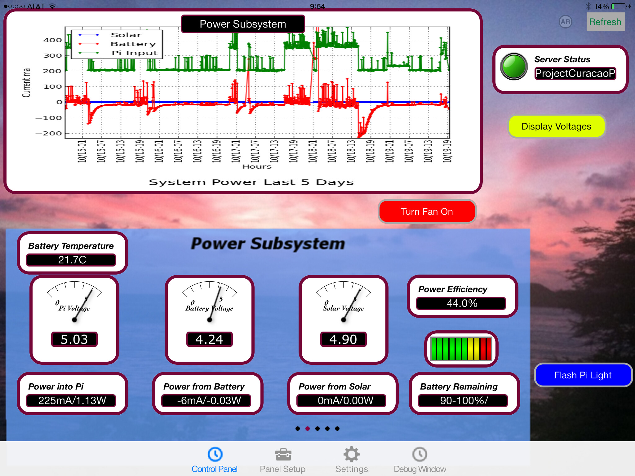

I'm building a solar powered arduino Mega-based system and using ArduinoConnect ipad App for remote control.
One of the things I do is turn on and off a fan from my iPad (with the app above) in addition to graphs and meters (pic below).
Since it is a solar powered system, I'm very concerned about current draw and have put INA219s through out the system so I know just where the power is going.

A picture of the control panel is attached.
Note that while I am reading the currents from INA219s connected to the Arduino I2C bus, I put the data in a MySQL database on a Raspberry Pi to crunch the data and build the graph using matplotlib in python. So in the picture below from my iPad, the graph is connected up to a Raspberry Pi and the meters and buttons are connected to the Arduino directly (across the internet of course). ArduinoConnect allows me to mix end computer devices on the same page.
