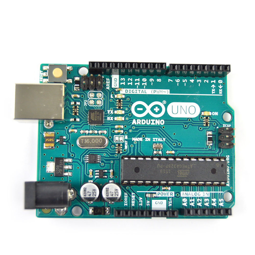

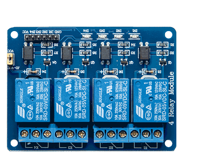

I'm fairly new to Arduino and I would like some advice for a project with the following constraints.
*4 Relays.
*4 Push buttons.
*Using the normally open contacts on all relays.
*Activating a relay closes contacts.
*Activate a relay with a push button (active low) (INPUT_PULLUP) type.
*Once any of the relays are activated by pushing a button all other relays must disconnect.
This is for switching a common signal (200-800mVpp AC sinusoidal waveform) to ONE of FOUR outputs. Only one at a time. So each relay's common point will be connected to the incoming signal and when a relay is activated the signal with go out that corresponding relay and all others will stay disconnected. Additionally if another push button is pressed I would like all the relays to deactivate and then activated the relay corresponding to the button that was pressed.
Arudino being used: Arudino UNO R3 (see attached)
Relay module being used: 4 Relay Module (see attached)
I'm not sure how this code should be structured. How should the deactivation of the other relays take place when another button is pressed?

Thanks for the quick reply. Attached is a schematic of what's going on. Refer to the relay module picture previously attached for the "Relay module driver circuitry" (Driver transistor, flyback diode, optoisolator etc...)
EJ

I updated the code to have an initial startup so that CH1 is activated and the others are deactivated. Preventing all relays from being active on power up. I changed the digital output pins to 12, 11, 10 & 9 so that when the unit boots relay 1 isn't clicked on and off a few times. On boot up it seems that the LED attached to pin 13 blinks a few times which subsequently clicks the relay. I also added more comments.
I'll try the de bouncing stuff later. For now proof of concept is adequate.
Thanks for all the help. It's most appreciated. 8)
