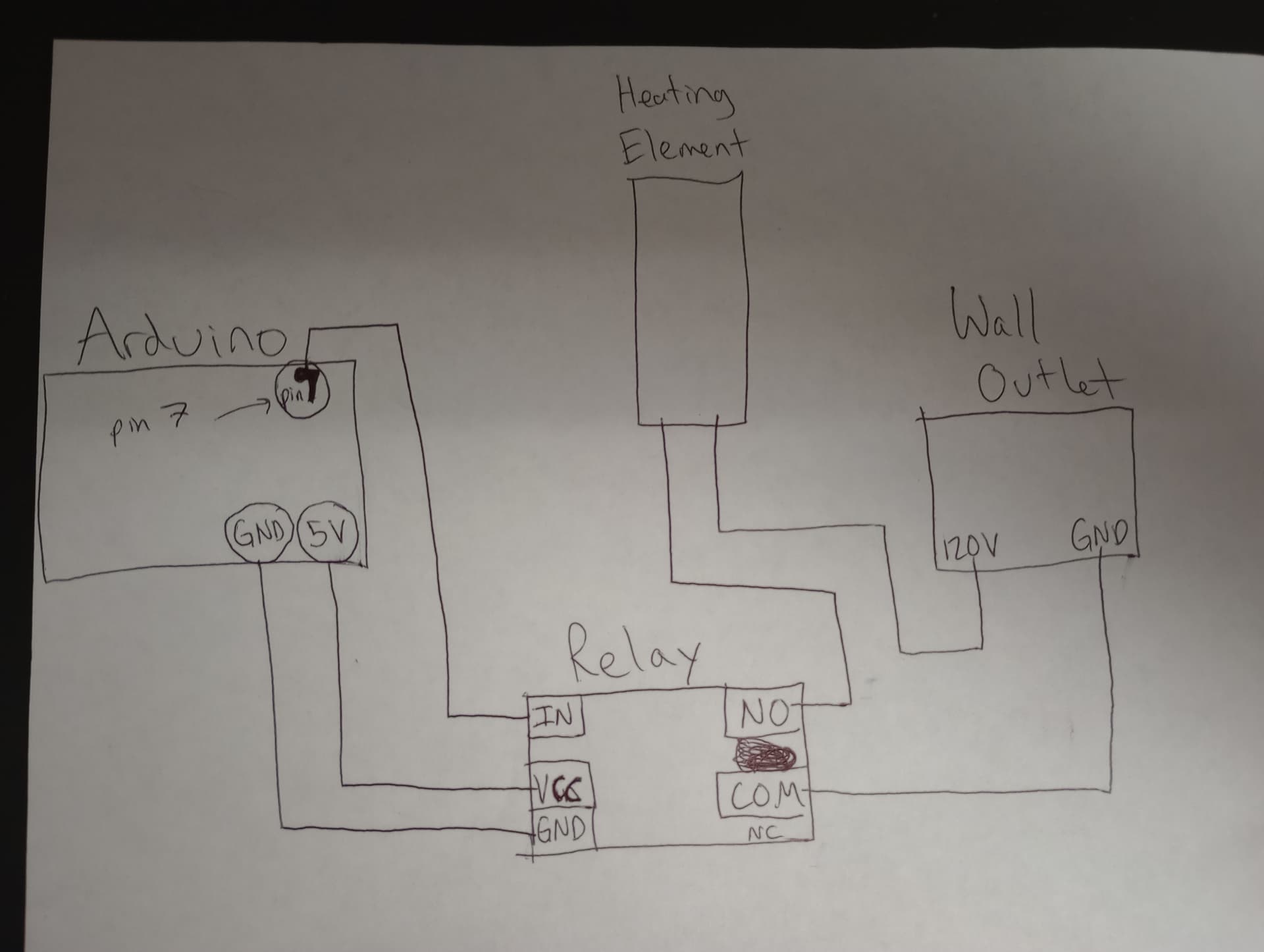

What's powering the 'control side' of the relay? Arduino's 5V output? I see there's no indication of what current the relay coil will draw. While not likely germane to your contact burnup, it's generally a bad idea to run this style of relay from the 5V output, unless you always power the board from your USB.
So, a circuit schematic would be informative.

Here is a schematic.
Yep. 86400 contact arcs per day will do it*. Simply put, your contacts will melt. While RC snubbers might prolong the survival time quite a bit, I think it's a foregone conclusion that this will be a band aid, not a cure.

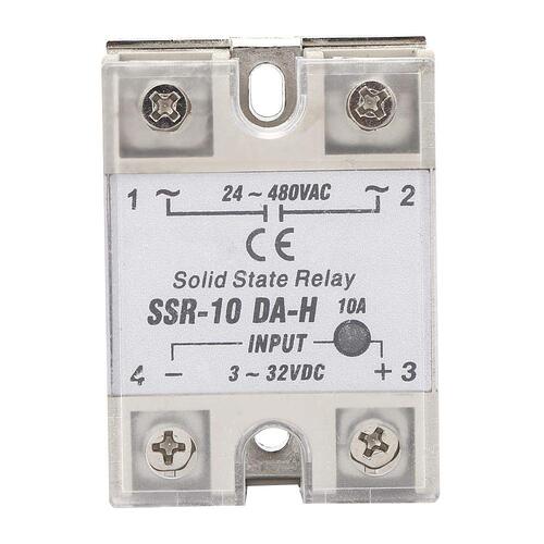

I'd go with something along the lines of:
You will note that this has a smooth metal backplate. At higher currents, the device must be mounted to a backplate, or even better, a heatsink, to remove heat from the body. In my experience, your application may not require that, but it would be good to mount it to a chassis, at least, and 'finger-test' the chassis at a time when the output is all, or mostly, on, to get an idea of how warm it gets.
Beware of one thing - they don't give an input current rating for the '3-32VDC' control signal. Your Arduino won't like a load much beyond 20-25 mA(it depends on whether you've any other loads on other outputs, not just the single output used to drive this module).
Since they give you no indication, it would be wise to test it before hooking it to your Arduino output and "hoping for the best". If you have a DMM, use it in mA mode, with a 9V battery for source, and measure the current drawn by the input of the module. Nothing needs to be connected to the outputs.
If that sounds daunting, ask for more details. If you don't have a DMM, then you're going to have to just try it. It's unlikely the module will draw much more than your present relay module, but it might.
Others will no doubt have better advice, or suggestions for cheaper sources.
  • although, I doubt they're opening and closing that often, unless your algorithm has zero hysteresis and is bobbling around some setpoint vs analog reality transition; that should be fixed anyways, regardless of control method for the heater.
Thanks! This is really helpful. I will work to improve my algorithm so that there they relay is experienceing fewer open/close events in parallel to making hardware upgrades.
The next phrase give the current Control Current: DC: 3-25mA . The input is typically and LED with a series resistor, so the higher current will be with the higher input voltage. I suspect with a 5V input the current would be in the 5-7 ma range.
My fault, chose one image on Amazon, the listing had no current rating, found a better one, didn't cross-check. D'OH, Homer's Irish cousin at work!
You're right, that one SSR would be fine. However, the OP will need to check whatever product is chosen to ensure the current is acceptable, if it's even given.

Also, I notice that this SSR says the trigger current is 7.5mA/12V. That seems like it would be OK for the Arduino, if I'm understanding correctly.
I guess that you are also measuring the temperature somehow and controlling it using the heating element which is powered via the the relay to adjust it. If that is the case then add some hysteresis so that the relay is not switching so often. For example switch the heater on when temperature X has been reached and switch it off when temperature X + 3 has been reached. Show the code that you are running on the Arduino for suggestions.

Some words about SSR inputs. Generally, think of them as a resistor in series with a light-emitting diode. At their lowest input voltage, for example 3V, the resistor limits the input current to (3-VLED)/R; we don't know what the VLED is, but if we assume 2V, and R = 1000, we have 1 mA through the LED. At 32V, the LED is seeing (32-2)/1000, or 32 mA. It's probably designed for that, but effectively, that's a 32:1 current range, over which the output stage must remain on. Remove the input current, the output stage must pass no more than the stated leakage current.
Off leakage current: 2mA
Now, beware of that leakage current. NEVER touch the output screws of the device, or wires connected to them, when line voltage is connected, because that available leakage current can give you a nasty jolt. Assuming "oh, the output is off, I removed the drive signal, I can make that change without disconnecting", is a bad, bad move.
Note, 7.5 mA at 12V implies 10V/0.0075 = 1333 ohms, so at 5V that particular SSR will draw (5-2)/1333 = 3.75 mA. Back of the envelope, but good enough to say you're quite safe to drive that from most/all Arduinos.
