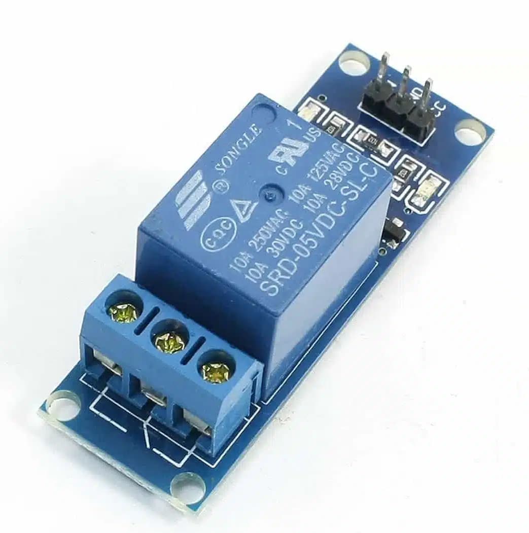

Relay got really hot
So it won't work with my 9v battery? I need a 12 battery?
Oh that's why it started burning. It couldn't work because it required 12v.
NO … as answered before in post 3 it started burning because you created a short circuit
IF you buy a 5V relay and connect everything as you show in post #19 with a 9V battery, it will work
the symbols are a poor attempt to show where the switch would be.
Other module do a better job by making the lines longer
so the one on the right (the 2 wires seems to touch, being closed) is the normally closed and the other (which looks open) is normally open

Just based on the photo you provided I simply looked up the datasheet and found it from the manufacture. This is the datasheet for just the relay since you did not communicate the manufacture of your relay board.
Songle Relay, 12v
Start with the part number SLD-12VDC-SL-C
SLD = base part number
12VDC = 12 volt, direct current (This is the voltage rating for the relay coil)
S = Sealed
L = 36 watt coil power
C = Contact Arrangement

I believe you are reading the data sheet incorrectly. The relay is available with several different coils, ranging from 5V to 48V. The coil data chart is showing, for each version of the relay, what the nominal coil voltage is, how much current the coil draws at that voltage, and the resistance of the coil itself at that voltage. You will not be able to reliably power a 12V coil with 9V, the resistance of the 12V coil is 400 ohms, at 9V the coil will draw 9V / 400ohm = 22.5mA, less than the normal 30mA at the rated 12V. The resistance from the chart is mainly useful if you want to use a high voltage, in which case the data is used to calculate the value of an external current limiting resistor.

If you look at the data sheet, under ordering information, it describes the part number.
SLD is the part number for the relay itself
12VDC is the type of coil, this can be 5VDC/6VDC/9VDC/12VDC/18VDC/24VDC/36VDC/48VDC depending on which coil the relay contains.
S specifies sealed, this can also be F for dustproof
L is the coil power - L for 0.36W, D for 0.45W
C is the contact arrangement, the A and B types have only two contacts, A being normally open, B normally closed. C has three contacts, where the center contact switches between a normally open and a normally closed contact.
