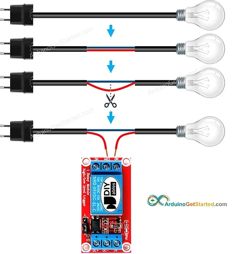

I want to make my arduino turn on/off a solenoid valve. Because the valve requires 9v, I decided to use a relay. I didn't find nearby any 9v relay. I got a 12v relay instead. When I was trying to test it, with my 9v battery (red wire to NO pin, black wire to C) something started to smell and I touched the relay and it was really hot. What happened?
Post a connection and wiring diagram.
you created a short....
the relay is just a switch along ONE wire. the other one goes straight to the load
(from https://arduinogetstarted.com/tutorials/arduino-relay)
(replace the bulb by your valve - hopefully it has an embedded freewheel diode)

yeah it's the wrong way... as in the picture above, only one wire goes to the relay (in an out basically) the other wire goes to the device you want to power
see that as a switch that you can control through software rather than pressing on it

I hope you have a lot of spare parts. Never put a power source (Both Plus and minus) across a relay contact. Relay contacts go in series with the load so wire from battery to relay NO. From relay C to load and from load to other side of the battery. Note LEDs fry very rapidly without using a resistor, You need something in the 1K range to start with. You can go to a lower value later if you want it brighter but this will keep it from destroying if connected to 12V. If your load is the LED it is polarized and will only working one direction. When you connect it to the battery and the NO contact short the NO to the C and it should light, if not reverse it.

The battery , the pump and the relay contacts form a circuit.
