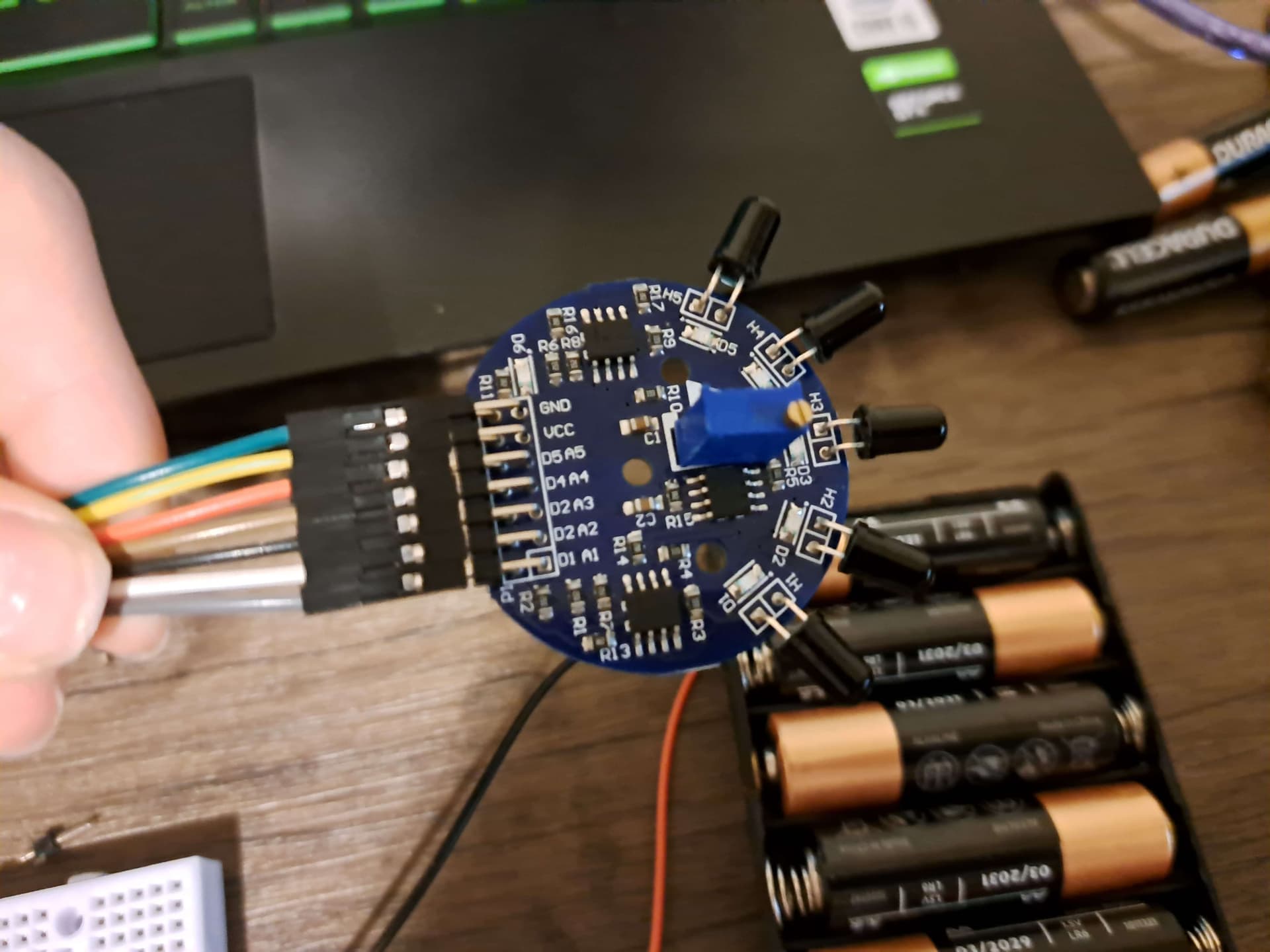

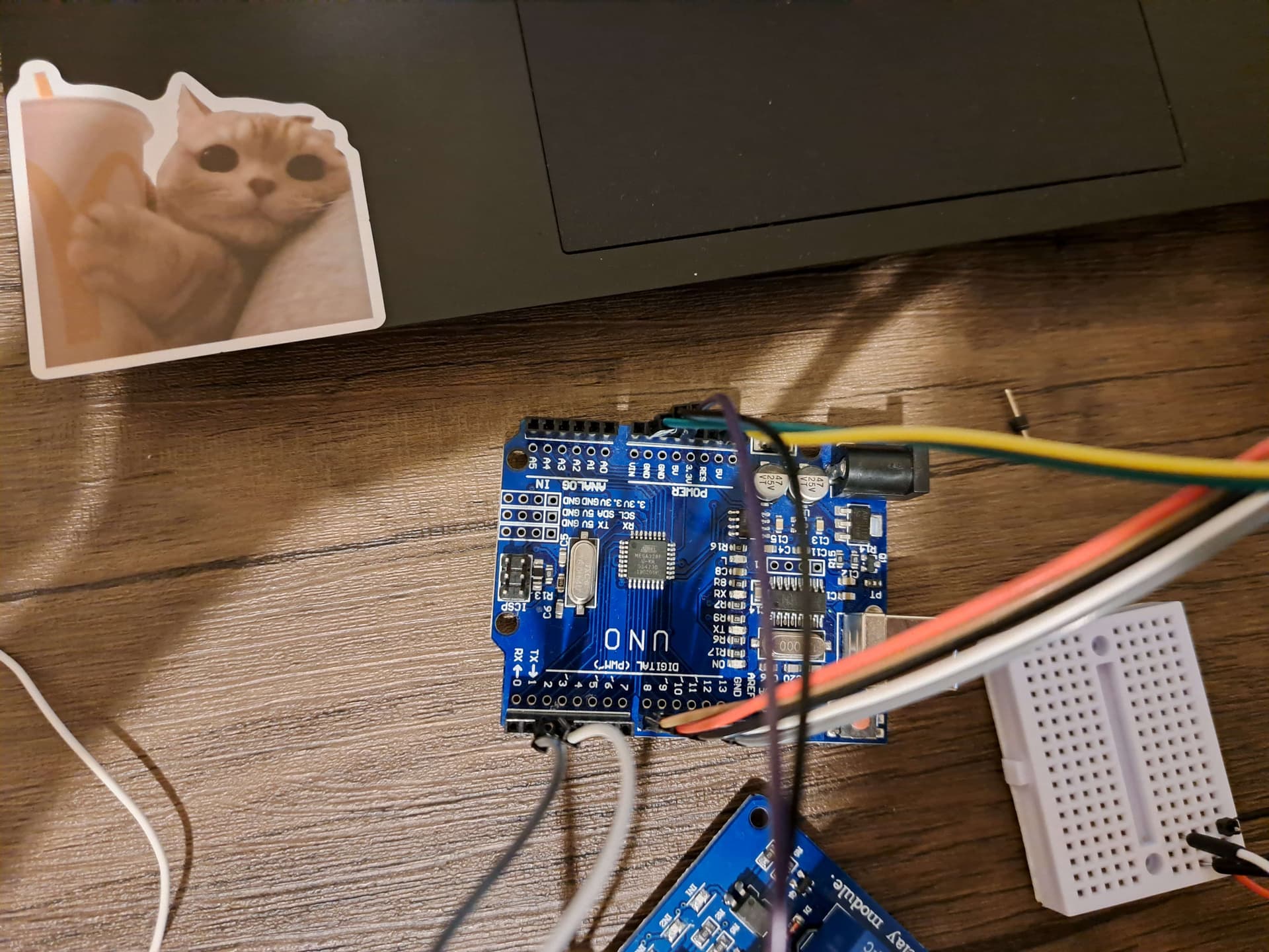

I've got a 5 channel flame sensor, a 4 channel relay, 2 water pumps, a breadboard, and a 6 battery power supply. I've wired the power supply to the breadboard and am using it to power the pumps.
The relay and sensor are both connected to the arduino. Problem is, whenever the sensor reads a positive and tries to turn on the relay for the pumps, it bugs out and doesn't do it properly.

And here are some photos of the wiring(I've only wired one pump to test it):

It is difficult to see all the wiring across multiple photos. How about a nice, hand-drawn schematic. Also, what do you mean by "bugs out"? Does the relay turn on? Does the motor run? You can always replace the motor with and LED and resistor so see if the motor is drawing too much current.

Could You present the data for the pumps? It might be bad to run their current through a breadboard.
A guess is You feed 9 volt to Vin. What things are connected to controller 5 volt? How much current do they use?
Hi! Sorry for the very slow reply. I'm a beginner to this stuff and honestly have no idea how to draw a schematic... I also don't have access to any other components since I left them at school... I mean that, after the sensor detects a 1, instead of turning on the relay forever like I told it to, it starts doing stuff like this:
On the site I bought them from they're called submersible water pumps 3-6V even though the stats below show 3-5V so i don't know...
Tension: DC3-5V
Current: 100-200mA
Also when I run just the relay with the pump without any sensor and tell it to turn on and off it does it flawlessly.
That us too much current for the controller 5 volt pin using Vin. Use a separat pump power source. The same for the relay power.
