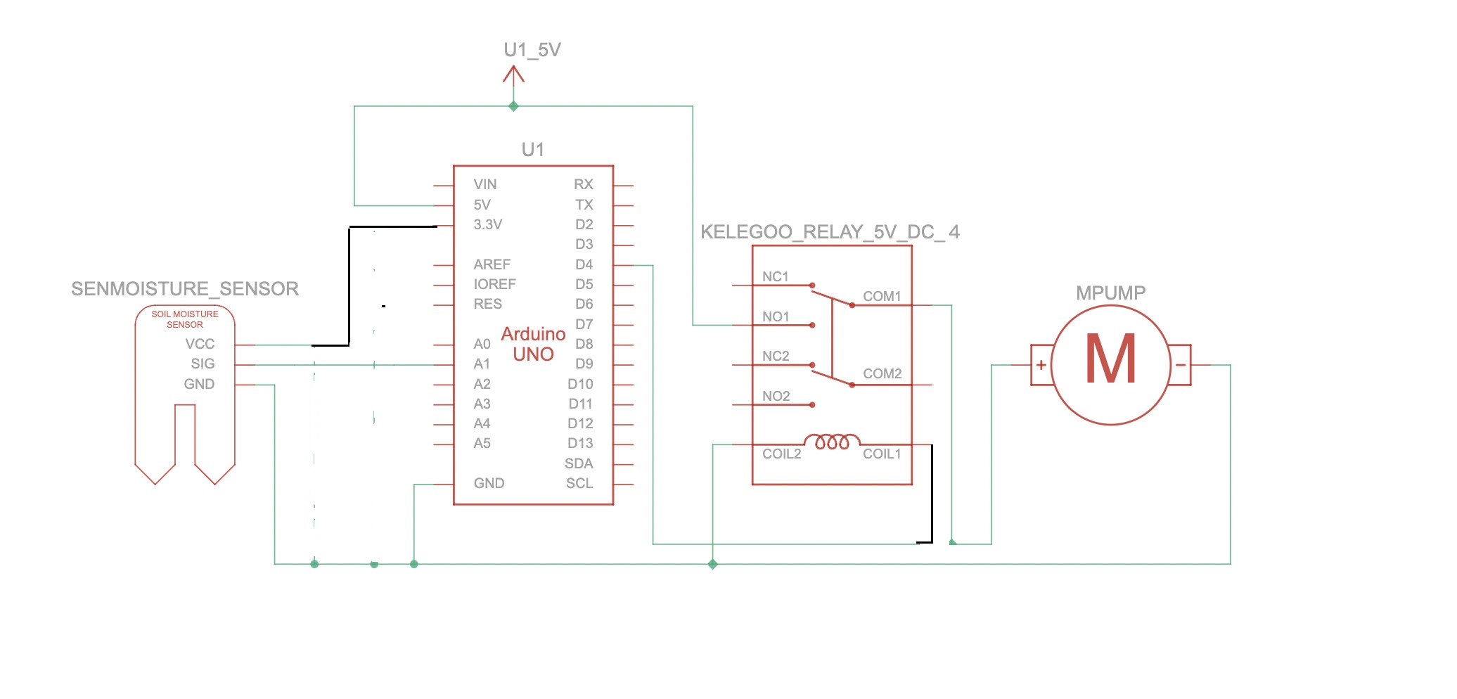

My theory is that the relay is not switching properly. You seem to have the relay powered by 3.3V but it is a 5V relay. Maybe your pump is running because it is connected to the COM and NC terminals? EDIT: your relay board has opto-isolators, so a LOW signal will switch on the relay and a HIGH signal will switch it off. This is the opposite way to the relay board shown in the tutorial.

You still power relay VCC from 3.3volt.
A 5volt relay module must be powered with 5volt.
Four relays on at the same time is borderline unsafe to power from the Uno.
You're still ok, because you're currently only using one relay.
You can't power a large motor from the 5volt pin of the Arduino.
Something is going to fry if you do.
The motor must have it's own separate power supply.
That could be four AA batteries in a battery holder.
If the motor stays on without driving the relay module, then the contacts inside the relay are welded together. This usually happens if you have forgotten to add a back-emf diode across the relay contacts. Try one of the other relays (after adding that diode), or give the relay a firm tap, to loosen the contact.

Can you please post a final schematic of your project?
Please no Fritzy pictures.
Sure ! Do you mean like this?
This is the first electronic circuit I draw! I didn't know what fritzy was. From fritzing[dot]com I guess ? I discovered KiCAD but it seemed too complex used Tinkercad. It looks nice! It even has a simulation with code integrated. But my sensor graph was going crazy, I don't know why. Don't hesitate if you have any recommendations, tips, or critics if I can get better with electronics :slight_smile:
I chose the bipolar relay as it looked like my Elegoo relay with 4 channels (even if it has only two in my graph).
By the way, I think I will be visiting your country very soon ...
Please forgive me if I didn't understand you very well, but are you saying that this tutorial about alternating current is interesting because I am not switching A/C but switching 5V DC current? Why is it very safe? Thank you for sharing your knowledge with the noob I am.
What I thought from your previous posts was that you are only switching low voltage DC current. But then you began to talk about AC currents and you seem to have concerns about safety, so I wondered if I could have misunderstood?
Low voltages like 5V are harmless to humans. Our skins have high resistance, so at low voltage only tiny currents will flow through our bodies, which are harmless. But at 120 or 240 V AC, things become very dangerous, even lethal.
It's forum slang for a type of wiring diagram created using the "breadboard view" in the Fritzing app. These are often very difficult to read and understand, preventing forum members from helping those that post them. However, Fritzing also has a "schematic view" which can be used to produce much more helpful/useful schematic diagrams, like the one you created in KiCAD or Tinkercad.
Who's country?
I've edited your schematic.
You have done well. :+1:
But you had some shorts and the gnd was not connected to the relay.
I understand that the relay you have drawn is not the one you used, which has transistor drive on its board.
Keep up with TinkerCad you will learn a lot from it, even how to make your own components like the relay module.
