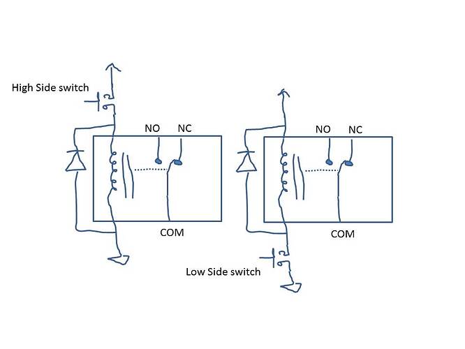

So (correct me if I'm wrong): The Arduino pin triggers the ground from the relay to the arduino gnd? This just doesn't make sense in my head since the pin is Positive and the Ground negative :stuck_out_tongue:
Think of it this way - the Arduino can control a High Side Switch, or a Low Side Switch.
Either way, current will flow from the Supply to Gnd when the switch is closed to energize the coil and make the relay contact flip from NC to NO.
If the supply is 12V, it is easier (needs fewer components) for the Arduino to control a Low Side Switch (i.e. transistor), because only a 5V signal is needed.
While the High Side, the control signal needs to go to 12V to turn the switch off, and Low to turn it on. 12V smokes the Arduino IO pin.
Ah thanks so much for that picture! I think I understand now :slight_smile:
