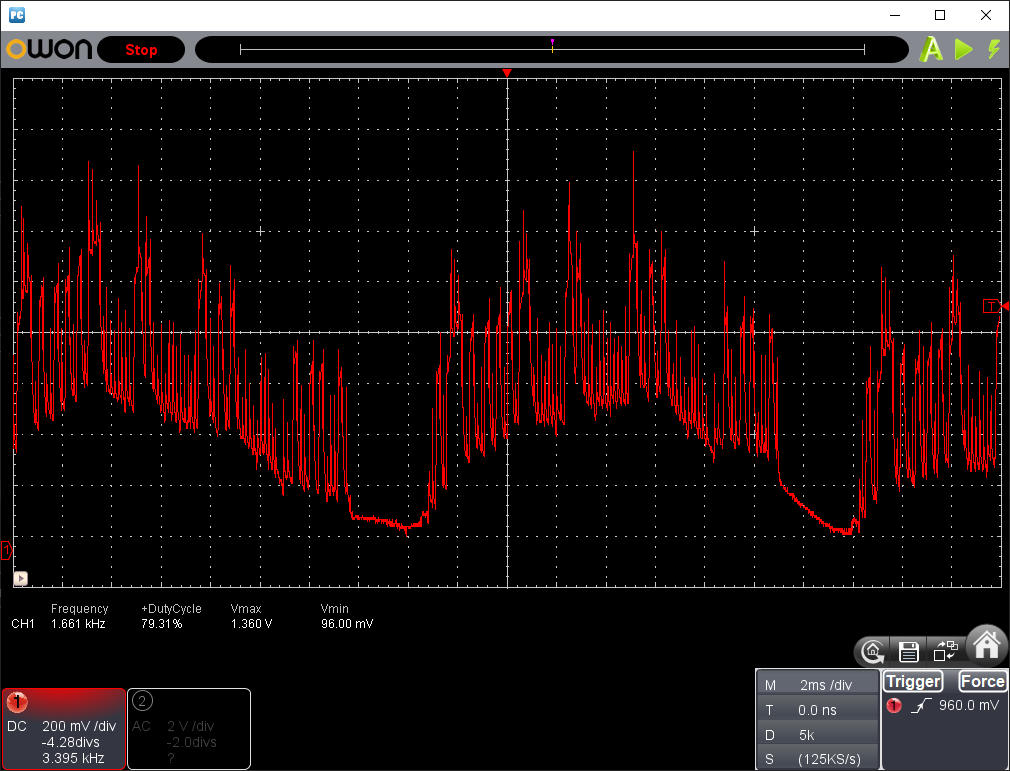

I have a TPIC6C595 controlling a SILK05-1A72-71D relay in my project (or a few of). The operation of the relay is as expected, it turns on when I want it to.
However, with the relay on, there is a lot of 'noise' or something I don't understand on the switch contacts of the relay. Is this just the voltage 'floating' on the switch contacts because they are not connected to anything yet? Or is this the relay inducing a voltage onto the switch contacts?
I am writing to the shift registers in the loop with a simple 'writeRegisters' function, could it be the Arduino loop switching the relay on and off ever so quickly?

It is difficult to know without your entire sketch. Those relays are mechanical devices and they will have noise when contact is first made. The datasheet also says the operation time (including bounce) is 0.7 ms (max). Are you trying to switch them faster than that?
No. I am only toggling on and off the relay when a button is pressed. So this waveform is seen until the button is pressed to move onto the next relay. Then if I move the scope probe to the next relay, you see the same thing.
This is why I am confused. I am not swicthing them on and off or fast. They are on or off.
If I substitute the reed relay with a hf3fa/005-htf the noise is non-existant. Could this just be a dis-advantage to using reed relays?
Or am I missing an electircal principle I should be applying to mitigate against the 'noise' when using reed relays?
With the reed relay I can measure (DMM) 1.2Vdc on the isolated switching contacts whereas I can read nothing from the HF3FA 0.001Vdc. Plus the scope picture of the HF3FA is just background noise, no horrible picture like seen above.
So I currently have 6 reed relays next to eachother, not all on, only 2 max. Just did some reading and...
Yes, it could be. You may have bunged up something in your sketch. Another idea, the power supply may not be powerful enough to supply the relay current, and is oscillating.

Where did you connect the scope probe and ground when you took those measurements?
If they are floating its probably noise from some part of your project and I wouldn't worry about it.

What noise signal do you see with the scope probe near, but not connected to the relay pin?
It looks like you are scoping an unconnected conductor, the open relay contacts. When it's energized, it's connected to "N/C" but I don't know if that is "no connection" or "normally closed" because you didn't show the rest of the circuit. Scoping an open circuit is like scoping an antenna for noise.
