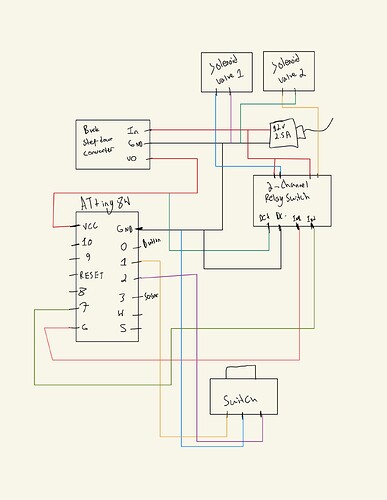

HI! I'm making a Halloween decoration that uses relay switches, an ATtiny84, and other small components. I'm supplying the whole circuit with a 12V 2.5A DC adapter, however, I also have a buck step-down converter that steps down the power to 5V for the relay switches and the ATtiny84. I've programmed the relay switches to open and close with a delay in between but for some reason, they open and close at a fast rate which is not how they're programmed to be. Moreover, after a variable amount of activations, the activation doesn't work unless I shut off the power and supply the power once again. I tried using an external 5V 2A power supply for the relay switches alone but that was also problematic (they behaved differently as well). I'm thinking that the way I supply the relay switches or the ATiny84 may be the root of the problem but I'm not entirely sure. Does anyone know what I might be doing wrong? Many thanks! : )

Circuit:
Here's a video of the relay switch using step-down voltage, and here's a video of the relay switch using external 5V 2A voltage.

Hi! I made the circuit again on a breadboard, however, instead of using an ATtiny84, I used an Arduino Nano where I powered the relays via the 5V pin (the Nano was powered using the USB). Everything seems to work exactly how I wanted but I'm a little puzzled as to why I can't get this to work properly with the old circuit. The wiring is correct and the voltage going into the ATtiny84 and relays is ~5V and no more than that. I'm guessing it has to do with the ATtiny84 since even trying to activate it with the button or sensor is finicky. I might just go with the Nano if I can't find the solution but do you have any idea what might be causing the problem?
Here's a link to the relays, and here's a link to the ATtiny84.
EDIT: I just tried the program out with a different ATtiny84 and it seems to be working as expected now (I'm guessing the other one I was using must've been defective). Going to do some more tests and see if it fully works. Thanks nonetheless! : )
I don't see any supply decoupling on your ATtiny84, and I don't see any kickback diodes across your solenoids. That, and the build quality, could easilly upset or reset the MCU.

Hi! I'm still fairly new to working with circuits, could you elaborate on what you mean by the use of decoupling capacitors on my ATtiny84? Moreover, the use of kickback diodes across the solenoid valves? Many thanks! : )
The buck converter has buffer/decoupling caps on it's 5volt output, but you still must use a 100n ceramic cap between VCC and GND of the ATtiny84, very close to the chip.
Inductive loads (your solenoids) create high voltage spikes when you cut the power to the solenoid. That high voltage spike could upset/restart the MCU and/or burn in the relay contacts over time, making them weld shut. The solution is to add a (kickback) diode (1N4004) across the solenoid.

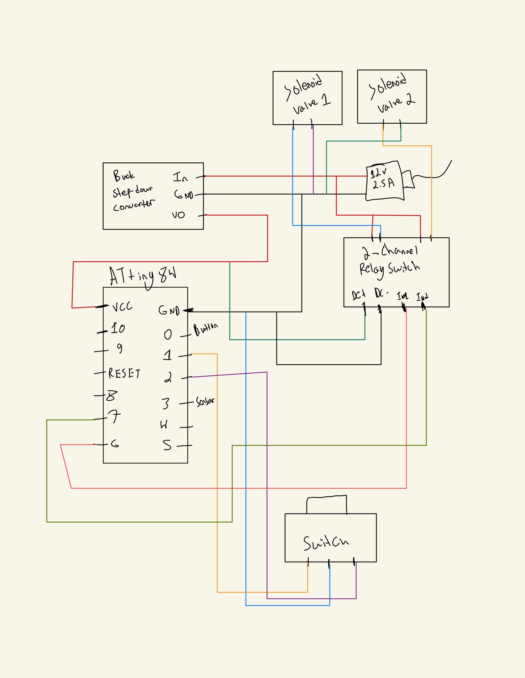

Hi, @a_friend
Can you please post some pictures of your project?
So we can see your component layout.
