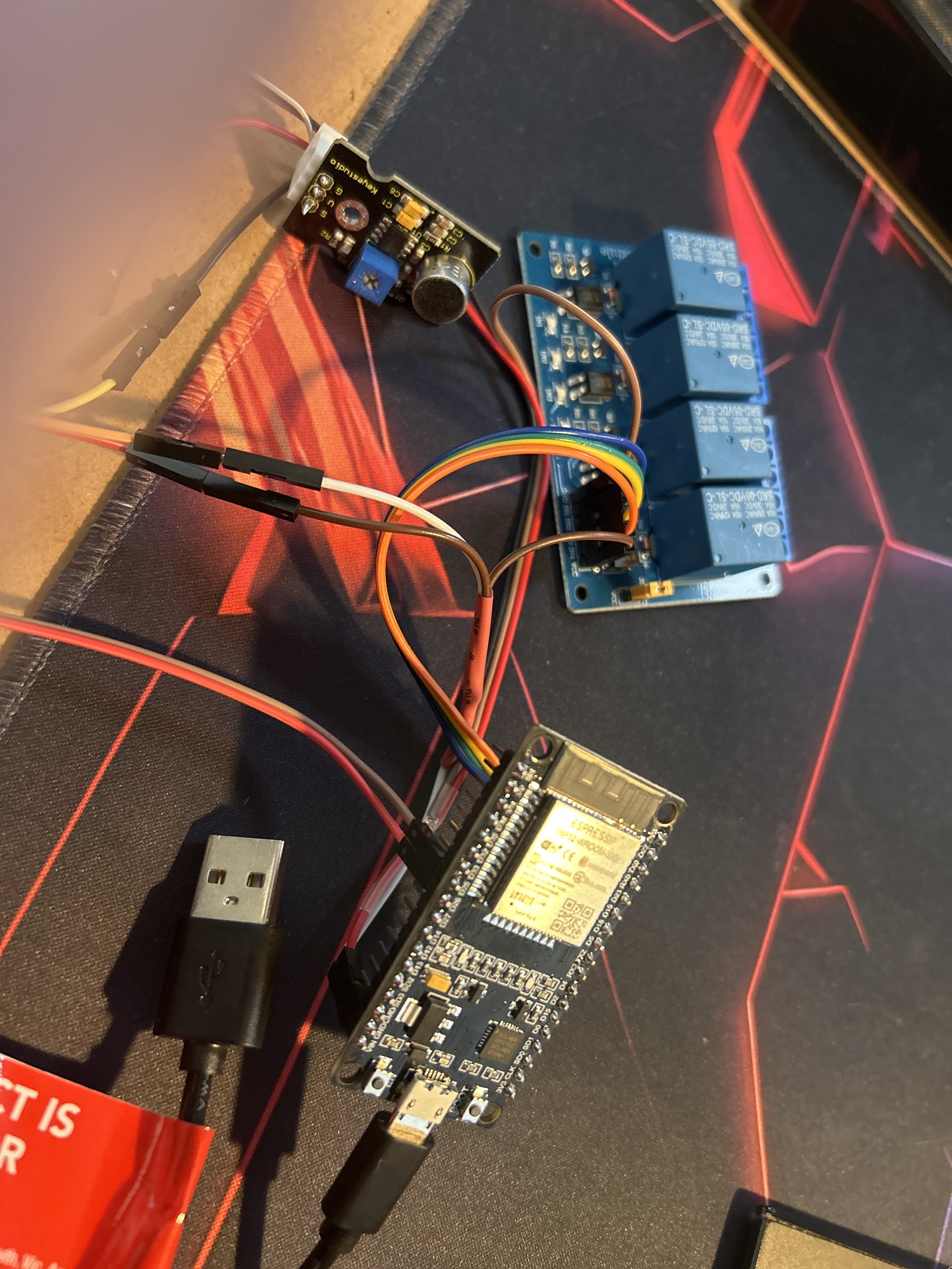

Hi all,
I have this really simple code for switching a relay on 3 seconds every time a sound sensor picks up a sound.
I don't know what is wrong but my relay seems to be doing the opposite and staying on and going for 3 seconds. I am assuming that when the relay LED is on the relay is on.
I am using and ESP32
Is there are way to get this working the way it should.

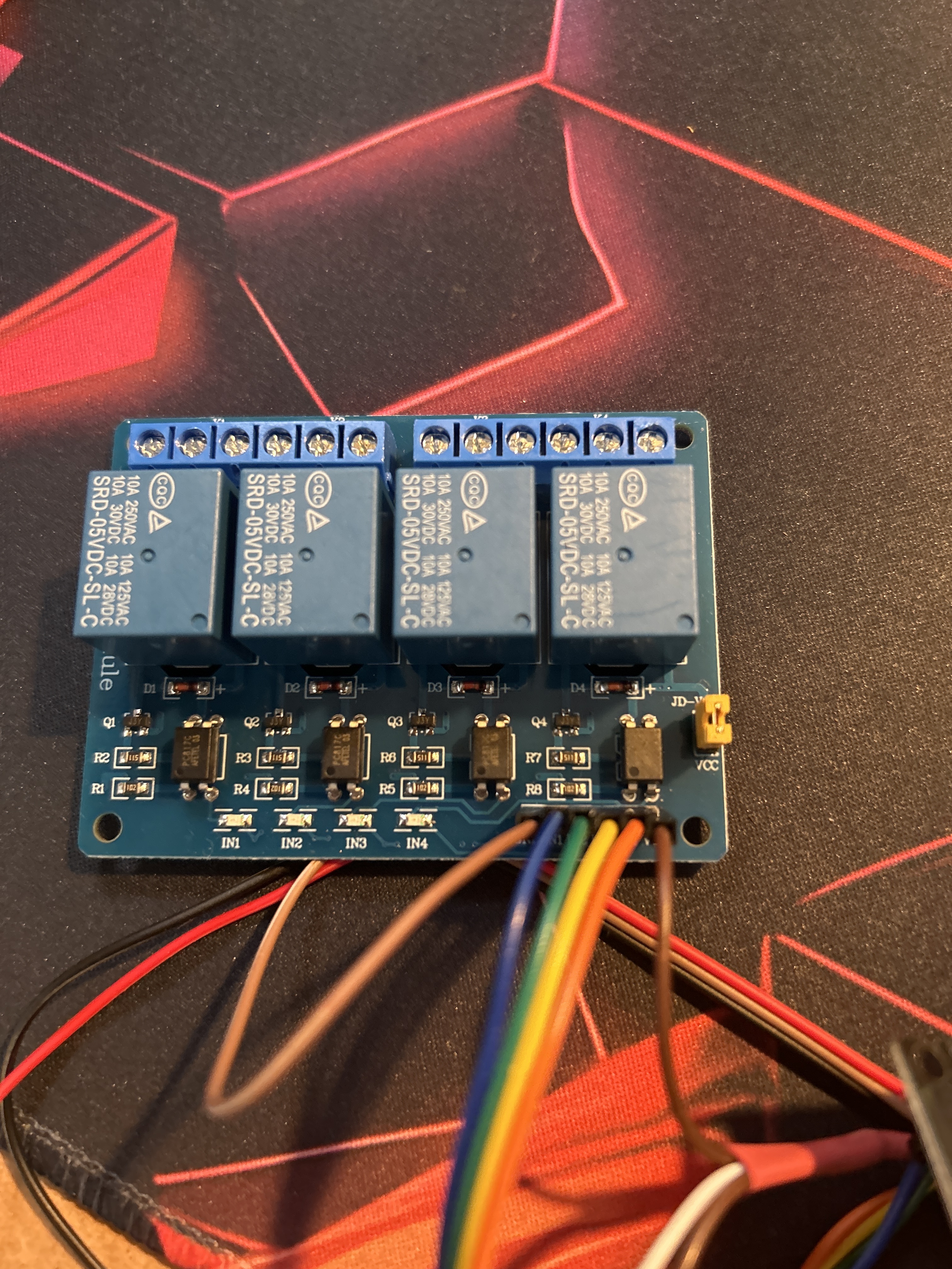

Post a link to the specs of your relays.
Some relay boards that have opto-isolators will switch the relay on when the input is LOW.
are you sure the mic-sensor is doing what you expect?

Extending @PaulRB's reply, you can use something like below near the beginning of the code
#define RELAY_ON LOW
When setting the relay on, use
digitalWrite(somePin, RELAY_ON);
and for switching it off
digitalWrite(somePin, !RELAY_ON);
This keeps it readable / makes the code easier to understand. If in future you use a different relay board where HIGH means on, simply change the first line to #define RELAY_ON HIGH.

Awesome thanks guys.
Here is the new code that works using all of your valuable advice.

On the above code I have four relays which should all be OFF when I start. The IR buttons are used to select a relay. One of 4. but They all start ON. and like before do the opposite. i.e, go off when the sound triggers them instead of the other way round. To me the code looks OK.
All good solved it. I swapped the definition of low and high over.

The correct way for these opto coupler relays on an Uno is:
  pinMode (RELAY_1_PIN, INPUT_PULLUP); // first enable internal pull up
  pinMode (RELAY_2_PIN, INPUT_PULLUP);
  pinMode (RELAY_3_PIN, INPUT_PULLUP);
  pinMode (RELAY_4_PIN, INPUT_PULLUP);
  pinMode (RELAY_1_PIN, OUTPUT); // then set to output
  pinMode (RELAY_2_PIN, OUTPUT);
  pinMode (RELAY_3_PIN, OUTPUT);
  pinMode (RELAY_4_PIN, OUTPUT);
This stops the relays from briefly activating during bootup.
This might not work on an ESP.
In that case, replace the first block with
digitalWrite(RELAY_1_PIN, OFF); // first enable internal pull up
etc.
