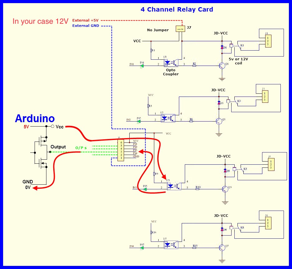

Hello, I am facing a weird problem that when I power off the following device, the relay module is turned ON for a second and turned off. I tried with different module but facing the same issue. Here is the conncetion diagram. BTW the program is working as expected but the only issue while switch off the device.
I am not sure what could be the issue.
@LarryD can you help me to resolve this issue?
Relay ground needs to be connected to Arduino ground

Is it a 12V relay module?
  • Actually no, the Arduino pulls the relay module input to GND to energize a relay.

Yes this is 12v relay module. If I connect both arduino GND and exyernal power supply GND then relay is directly ON though the trigger pin is not activated by the microcontroller.
  • Don’t connect the GNDs

My primary concern is while power off this entire device the relay is enerzised for a second and then finally switching OFF the entire device as there is no power supply.

The wiring diagram image is already attached with my post. That is my actual wiring connection diagram.
I am not using NC of the realy because it is not required at all for my requirement.
I am using only COM and NO of the realy to control the external devices.
My requirement is simple. If I connect pin3 to arduino GND pin then need to be enerzised the relay and if I connect pin4 with GND the relay should deenerzised.
But the problem is not with overall functionality but while turning off the device the relay is triggering for a second. I am not sure whether the issue with wiring or sketch.

Actual wiring diagram or phto of my device wiring??
Actually I am not using any buttons but I am trying to connect direct wire from MC pin to MC GND pin.
  • A photo of the actual wiring.
  • That’s fine, as long as a LOW means relay ON for Arduino pin 3 and
    as long as a LOW means relay OFF for Arduino pin 4
  • Assume Micro Controller
  • Describe the exact sequence of events that cause your problem.
  • Try the sketch in post #15
I connceted 12v VCC to the relay module jd-vcc (removed jumper) and 12v GND to relay module GND.
Connected pin 2 of MC to IN of relay module.
This is the overall wiring connection overview.
Now the issue is whenever I switched off the entire powersupply then the relay module is enerzised for a while and switching off.
