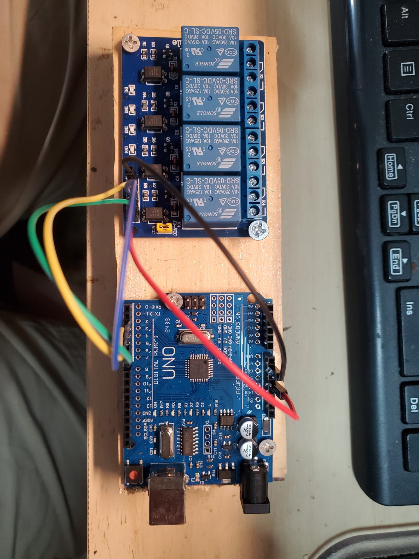

Relays stay on - clicking on and off
hi i just created an auto reel stop for a japan slot machine using an aurdino r3 along with a 4 channel relay, the problem i am having is that the relays click on and off even when the reel spin knob is not touched, can anyone help here with this if needed i can provide you my software program, thanks marcUse code tags to format code for the forum//japanese pachislot autostop mod:

Quite likely you don't have any pullups on your buttons.
You should use INPUT_PULLUP instead. (buttons wired to GND).

In short I suspect you don't have pull up resistors and you need to understand the difference between detecting when a button is pressed and detecting when it becomes pressed.
