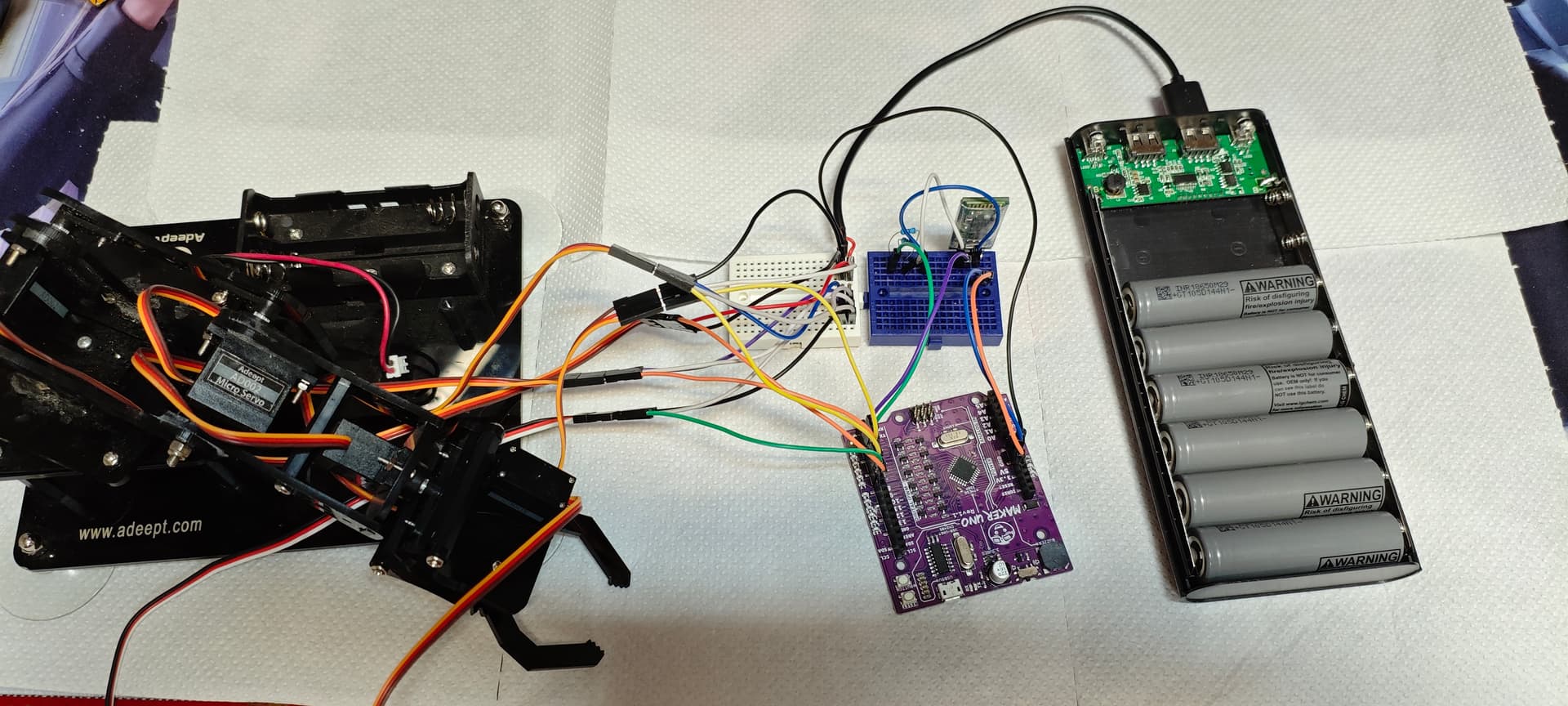

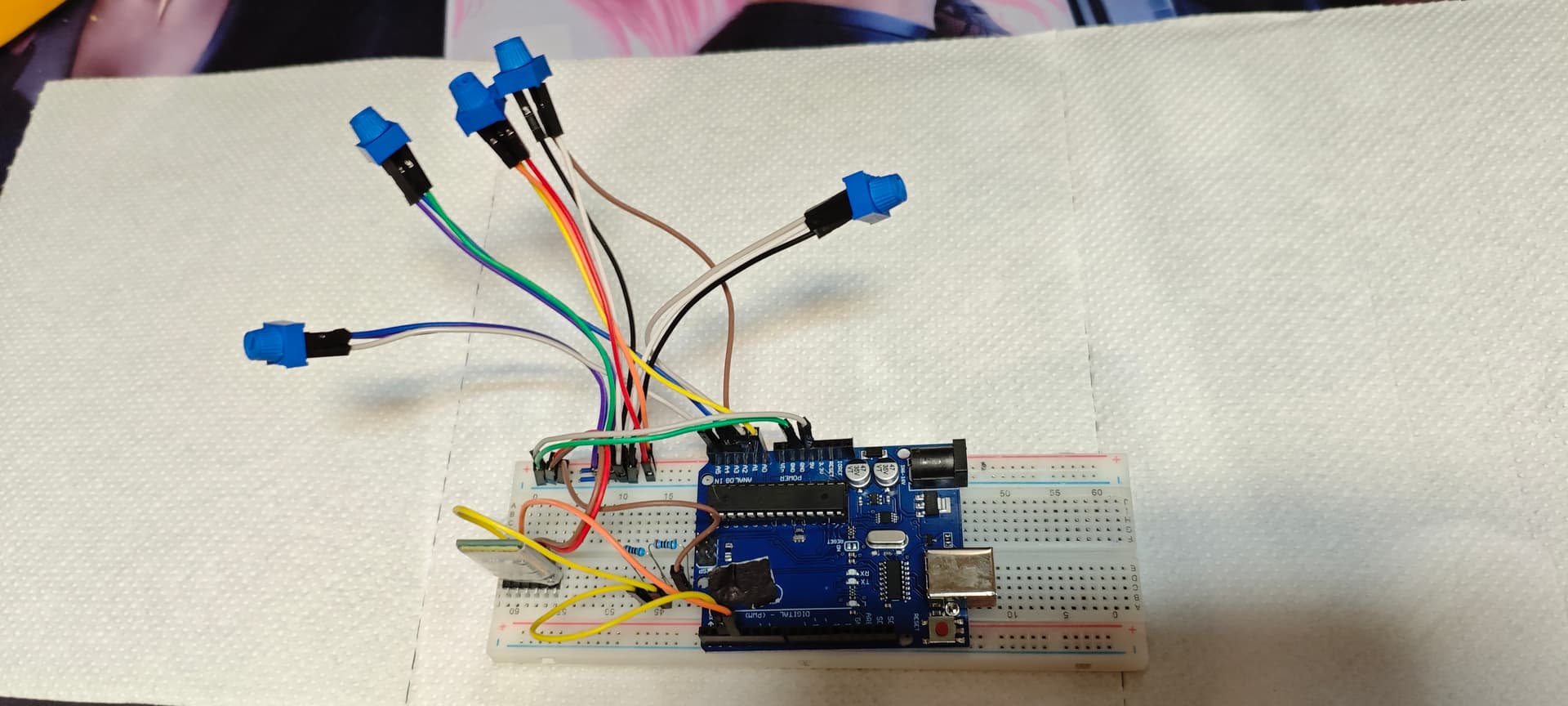

What I am doing here is I want to control a robot arm made by 5 servo motors. Those motors are controlled by 5 potentiometers. The data form potentiometers is send by HC-05 Bluetooth module to HC-06. The modules are connected to each other and I am reading data form HC-05. The problem is that the robot trembles when the circuit is powered on. For the motors I am using power bank to power them up. Is there a way to remove this trembling? Components uno mini and other circuit is maker uno similar to normal uno. 5 10k oms potentiometers.

Jittering servos is usually a power problem.
Which servos (need to know stall current) and what is the current limit of your powerbank.
How is the Arduino powered.
Leo..

For the power bank I am using 6 INR 18650M29 lithium batteries they have 3.7v normally but I don't think it is form the power it is stable 5v output I test it.

Can you please post some images of your project?
So we can see your component layout.
Thanks.. Tom.... :smiley: :+1: :coffee: :australia:
Yes I have. One moment I will it is a bit messy because a lot of wires.

The limiting factor of the powerbank is the 3.7 to 5volt boost converter, not the batteries.
Do you know the current rating of the USB socket of that powerbank.
Did you measure the 5volt with a scope. A DMM is too slow to see dips in the supply.
Leo..
It has two ports one has 1A other is 2.1A. I don't have Scope and I measure the 5V with MultiMeter. Also the thing is that I change SoftwareSerial to NeoSWSerial and that kind of help to lower the trembling. It may not be this but I think is wort mentioning it.
Those servos draw a stall current of 650mA each, every time they start to move.
Do the math...
Try a mains powered 5volt/5Amp supply.
Leo..

Sadly when you were asked to post a circuit diagram you did not. What you posted was a physical layout diagram. This is allows someone with no idea of what they are doing to blindly recreate the circuit. This is in no way a schematic.
A schematic is the universal way to share your circuit with others.
